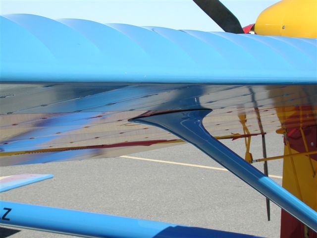

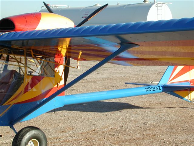

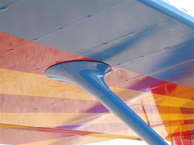

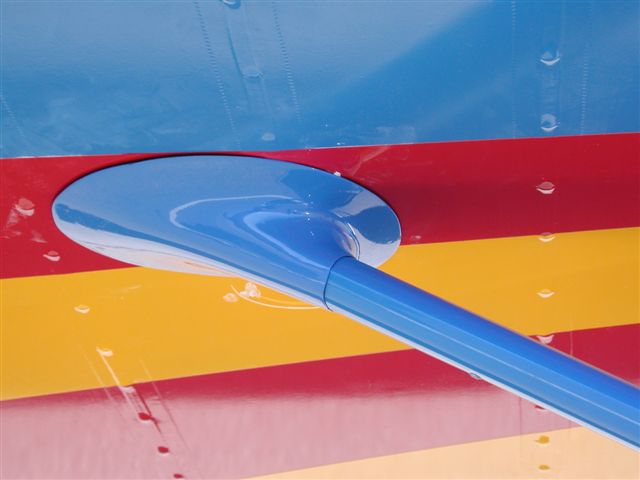

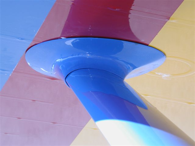

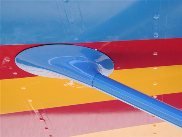

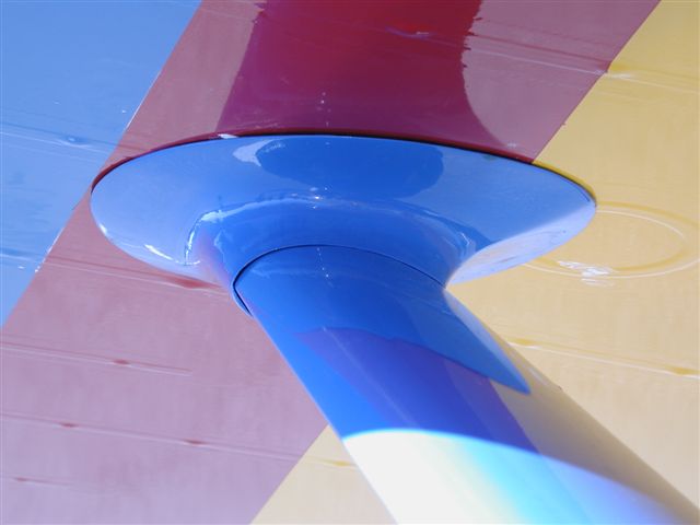

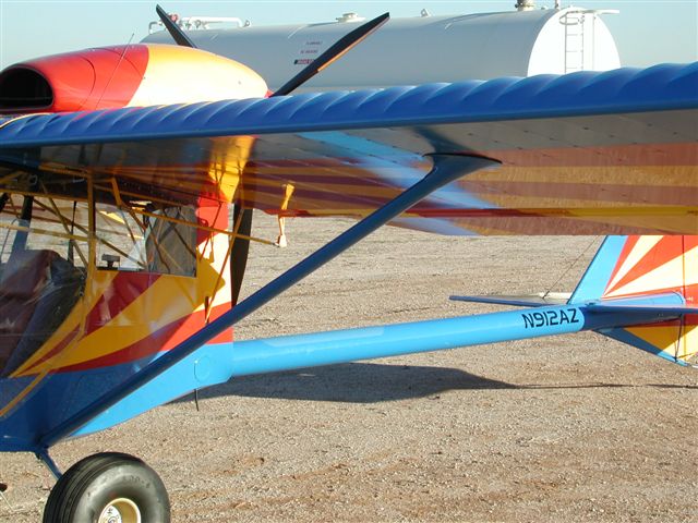

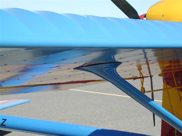

I did a flight today about 90 miles with some friends a titan tornado
and a Swiss bull dog. Level flight,59 degrees 3000 ft, 5100 rpm, and 90
indicated, 90 ground speed on the gps verified with the titan and bull
dog. There was some talk about streamlining struts a few weeks ago--- I
like the PVC ones as there are no bolts sticking out. I used masking
tape and plaster to make lost mold technique fairings at the wing end of
the airfoil strut. The part made of s glass and epoxy resin fits snug
around the pvc faring I got from Kolb and slides up over the attach
point after the pin is in place, then Velcro holds the part secure to
the bottom of the wing. If there were bolts to contend with it would
make this part much more difficult I plan to make fairings for the base
of the strut where it meets the fuselage. It looks like I will have to
make a cowl flap. I had to block off 1/2 of the radiator and oil cooler
to get up to operating temps. After my cardboard cowl flap the oil temp
was around 190

PostPosted: Sat Feb 02, 2008 3:59 pm    Post subject: Winter flight/ streamlined struts Reply with quote
I know I picked up about 6mph just by streamlining the struts.
That is a lot of drag - a round tube that long as opposed to
a teardrop shaped strut. There is almost nothing better you can
do to a stock plane to lose drag that streamlining the lift struts.
Plus - I lost the weird vibration and worry of watching the
lift struts go thru their little "shake rattle & roll" routine out there.
I'm sure it didn't hurt anything, but I just didn't like it.
Jeremy could do the math for you. I just know that it works.

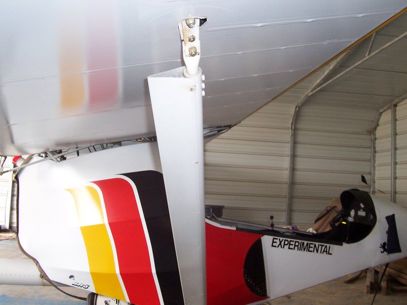

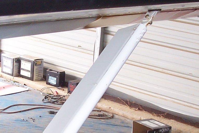

Homemade alum "sleeves"

PostPosted: Sun Feb 03, 2008 7:19 am    Post subject: Winter flight/ streamlined struts Reply with quote
Thanks for asking yes! We plan to run the Iditarod this year! Have had
to keep the dogs in the deep freeze he! He! He! If there is enough
demand I would consider making molds and offering them to any one
interested. Again right now my trailer is my hanger and the plane is
folded and put in the trailer every time I fly.( I hate it but It's a
kolb and it is possible) The strut faring goes on real simply. Just put
it on the strut slide it down, put the wing together secure the pin.
Slide the faring up to the wing to cover the bolts streamlining the end
of the strut and Velcro on the underside of the wing and the top of the
faring hold it in place. Takes all of 2 seconds to put on. To tie the
plane down simply pull the faring down from the wing to expose the
mounting point for tie down rope or chain
Uncle craig

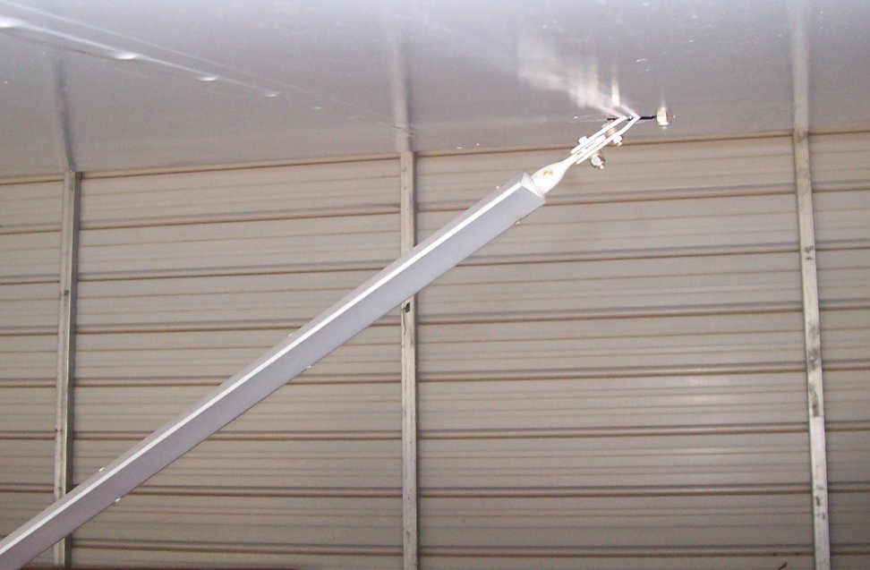

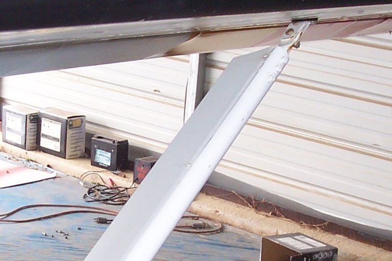

Possums
Joined: 03 Nov 2007
Posts: 247
PostPosted: Sun Feb 03, 2008 11:45 am    Post subject: Winter flight/ streamlined struts Reply with quote
At 12:45 AM 2/3/2008, you wrote:
How did streamlining the struts get rid of the vibration - did you
use the extruded aluminum struts?

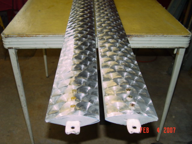

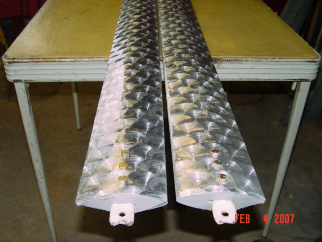

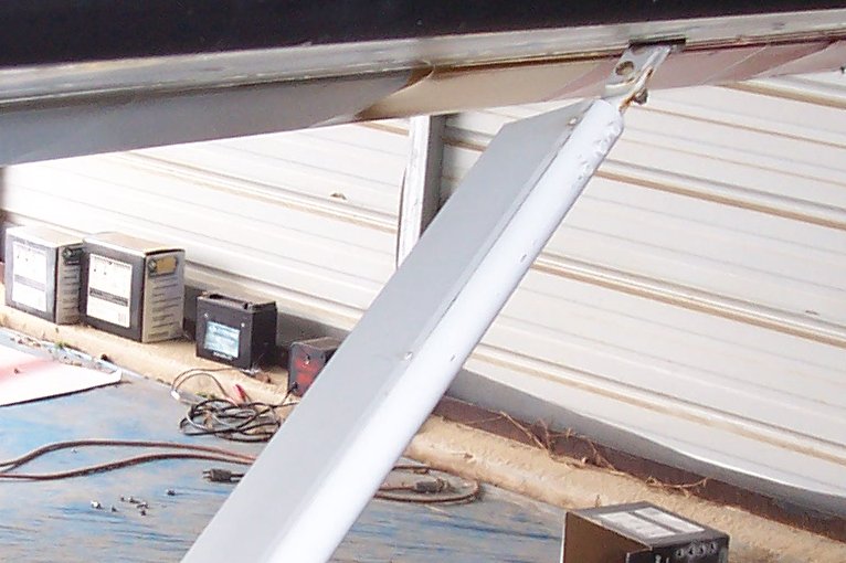

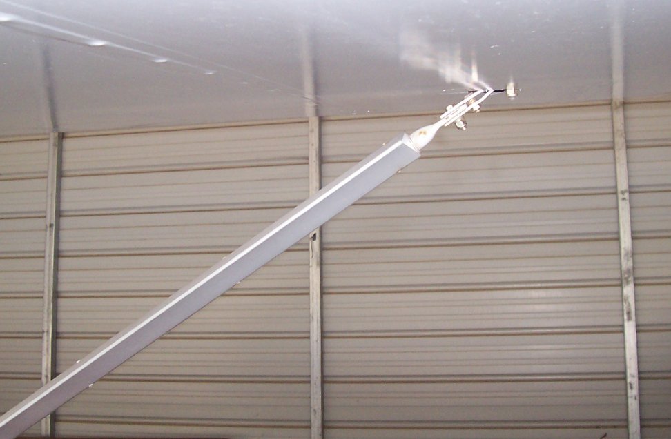

No - I just had some metal (T6061 I think) bent for me at a shop with
an 8 foot brake.
Had them cut it to shape, then roll both edges a little to partially
go around the strut. After that - bend it in the break. I riveted it on
the struts and with the rolled edges, it fits pretty tight. Been on
there for 10 years.
It stopped all the vibration and hardly weighs anything. But there
are all kinds of
ways to do it. Many are more aerodynamic than mine, but most weigh a lot more.
I would think that they all would stop the vibration.

Thanks for the idea and especially the photos. That's a very ingenious solution- light and simple, and looks like you get 90 percent of the benefit of a full airfoil. That would be perfect for my purposes. Seems like that would also be a slick way to streamline the aft end of the aileron torque tubes (like Jack Hart did on his Firefly), provided there is enough prop clearance.
