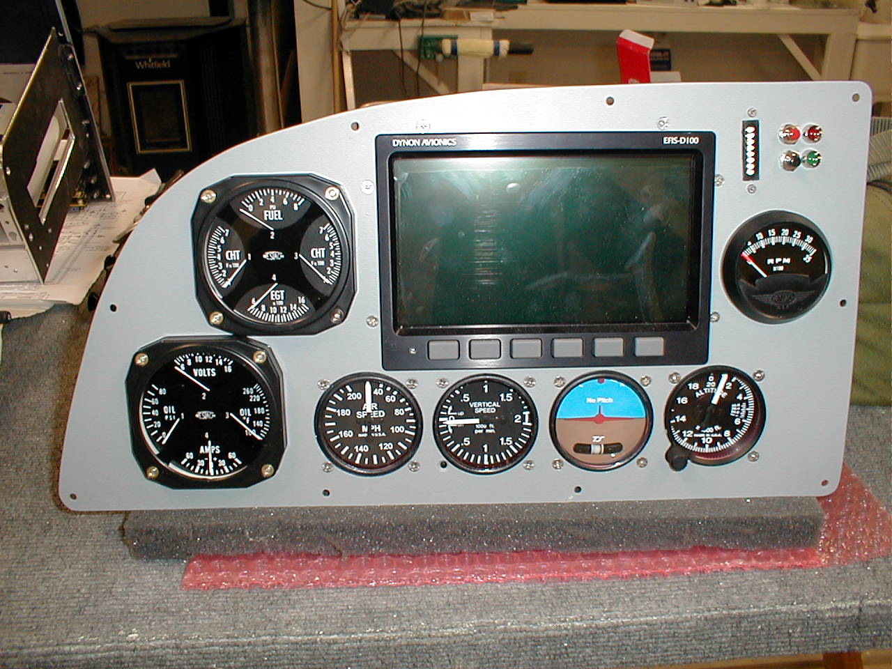

DuaneFamly(at)aol.com
PostPosted: Fri Feb 01, 2008 9:15 pm    Post subject: 2 1/4 inch ASI and Alt Reply with quote
Willie,
Still building, but this is my panel so far. But use the Dynon EFIS D-100, with it's internal battery back-up, as the main instrument, with the four 2 1/4" back-ups below. AOA to the right of the Dynon. The two quad gauges to the left now have a three position rotary switch so I can monitor all six cylinder temps. The only change so far is that I have replaced the redundant tachometer with a GT-50 from ACS. Though primarily for a G-meter, it is wired to my Emergency buss so that it's voltage reading will be my "Fuel guage" in the event of a alternator failure.
My right side panel has my circuit breakers, transponder, Nav/Comm, and a Garmin 296 GPS. The GPS also has it's own internal backup battery.
Mike Duane A207A
Redding, California
XS Conventional Gear
Jabiru 3300
Sensenich R64Z N
Ground Adjustable Prop
