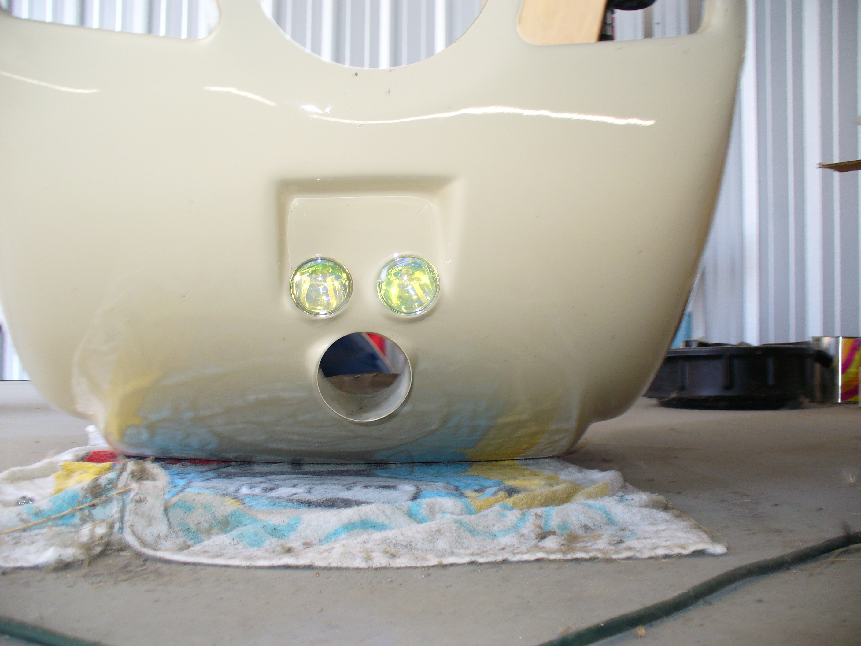

Guys, I do have a couple of pics I think will help. The first picture shows the additional scoop that directs airflow directly onto the oil cooler. At least that's the theory anyway. No provision was made to increase the size of the exit, so I don't know how much air is getting into that scoop. But I could be up in the night though... I'm pretty new to all this and haven't ever built a plane before.

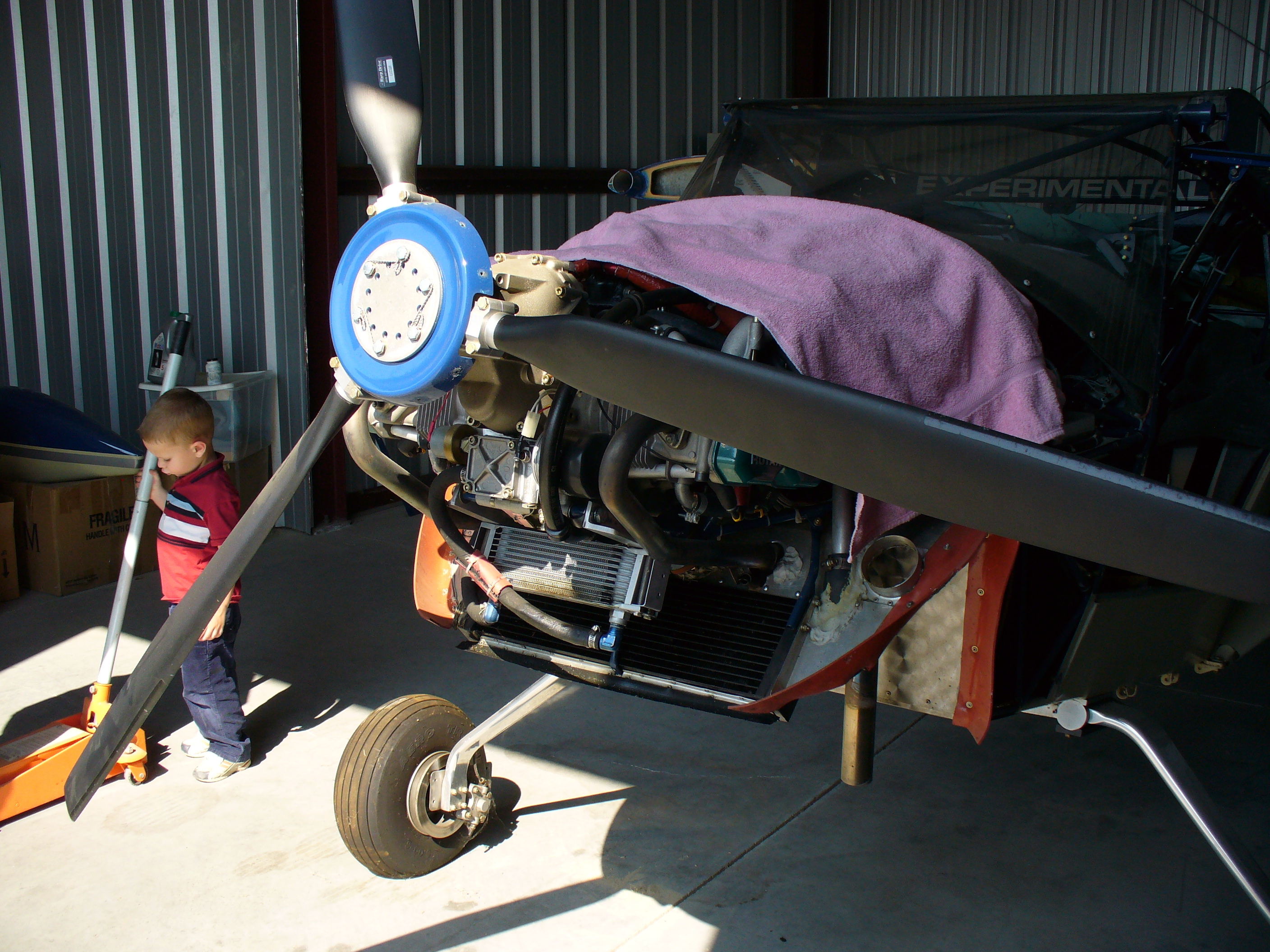

The second one clearly shows the routing of the oil lines. I don't believe they are kinked (maybe slightly - right before the oil pump). The radiator was mounted so that the in and out is on the bottom of the oil cooler. This allowed for more room in the bend to the oil pump (I'm guessing).

Good idea to provide a couple of pictures of the oil cooler install. I
would comment that the hose routing, into the bottom of the cooler, could
be the problem. Trapped air. Rotax install instructions advises against
this. I'd talk to Lockwood.

I finally looked at your pictures. (Dial-up connection, you know.) First I agree that the first impression is that it will be nearly impossible to bleed the oil cooler without some kind of air bleed screw on top. (Otherwise you'll have to remove the cooler and turn it over and bleed it manually. TOO MUCH WORK!
Second, it's entirely possible that NO air is going through you oil cooler. You see, in order to get air to flow through it there must be a change in pressure from front to back. (Or back to front, if you want the air to go backwards! It works just the same.) Looking at the coolant radiator you can see where that pressure differential derives. The front face of the radiator is at static plus some fraction of the dynamic pressure provided by the three forward facing inlets. (Called the total pressure.) The back of the radiator is at the pressure of the bottom scoop, which facing aft should be at something near the static pressure alone and therefore a much lower pressure than the front of the radiator. Therefore air flows through the radiator, from high pressure to low. (This even works at rest because of prop wash.)
Your oil radiator appears to have no air ducted to it, nor away from it. Both faces, therefore, are at the same pressure and it will only cool as a passive convection radiator, shedding heat to the air around it. (Like a radiator in a house.) Unfortunately your lower inlet may be doing next to nothing, because the interior of the cowl is already at high pressure due to the inlets above. Even if you were to duct the lower inlet to the oil cooler it might do nothing, because the back side of the cooler, being in front of the radiator, is at the cowl's high internal pressure. (It might cool a little bit, if the total pressure of the air at the lower inlet is higher than that at the inlets above, however it would be extremely inefficient, meaning low flow.)
What to do? Probably nothing. Most 5's I've seen mount the oil cooler to the front of the radiator. This combination of air and oil cooling appears to be enough for the job. (I suggest it might help to somehow "seal" the edge of the oil cooler to the front face of the radiator, thus forcing the full pressure differential across the oil cooler / radiator combo.) Otherwise, if you want flow through your oil cooler you'll have to pass air through it. This is usually done by ducting in and out, high pressure to low, like the radiator. You might have success with just ducting in, (some put their oil coolers right up front, blocking an inlet, and thereby forcing a pressure differential,) but it will be strictly hit or miss. (The Lancair guys have had some success using a spare ASI as a dynamic pressure meter and a spare altimeter as a static pressure meter. They then instrument their cooling system incrementally in an attempt to optimize the pressure drop.)
That's the short answer. By the way, nice job on the cowling.
