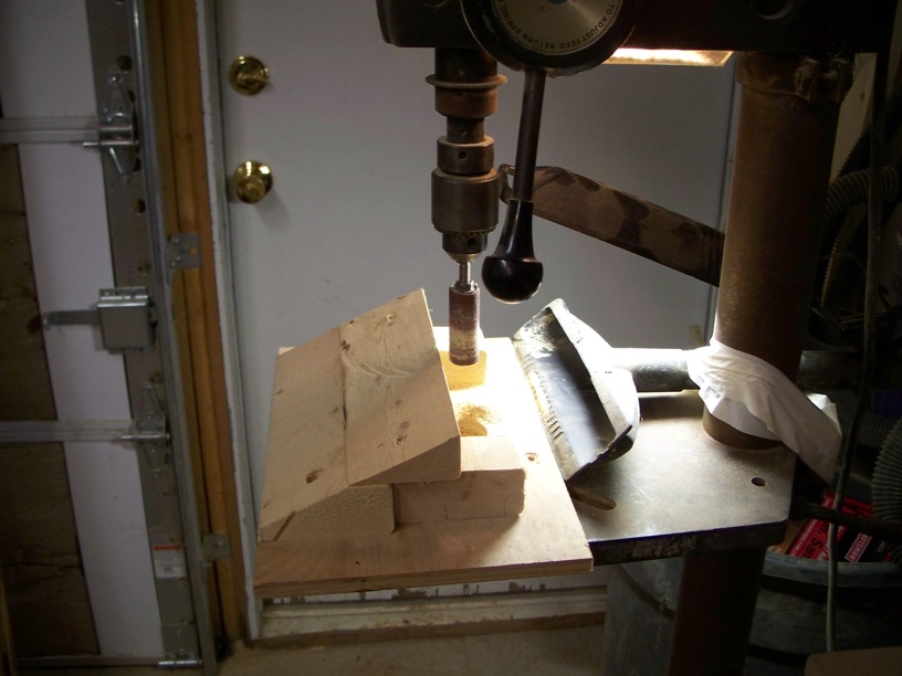

That's 270 relief cuts! I made a jig for my drill press and it works fine, but

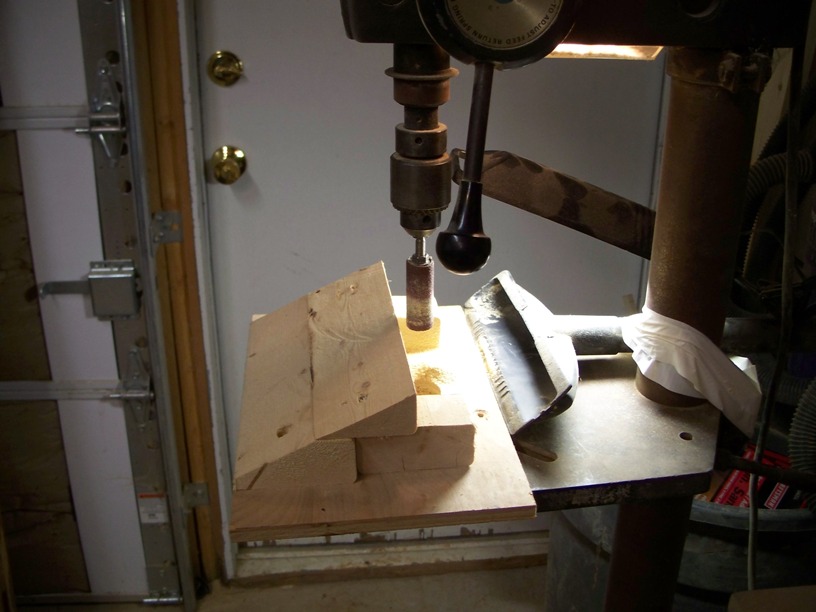

PostPosted: Wed Jan 30, 2008 10:03 pm    Post subject: Re: Forming blocks - a 'right of passage Reply with quote
Guys,
Here is a picture of my jig to make the relief cuts.
John Hines
www.johnsplane.com
