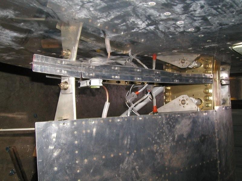

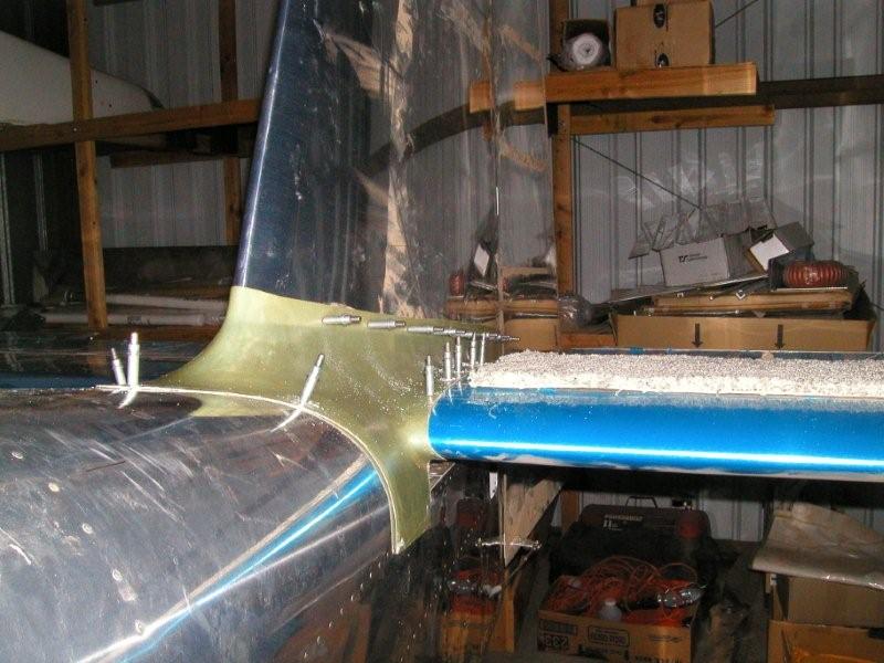

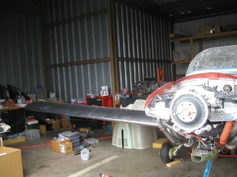

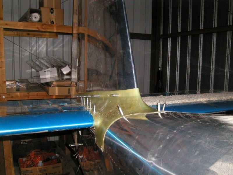

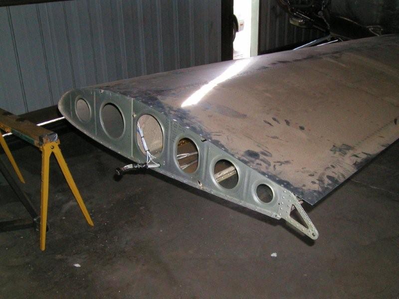

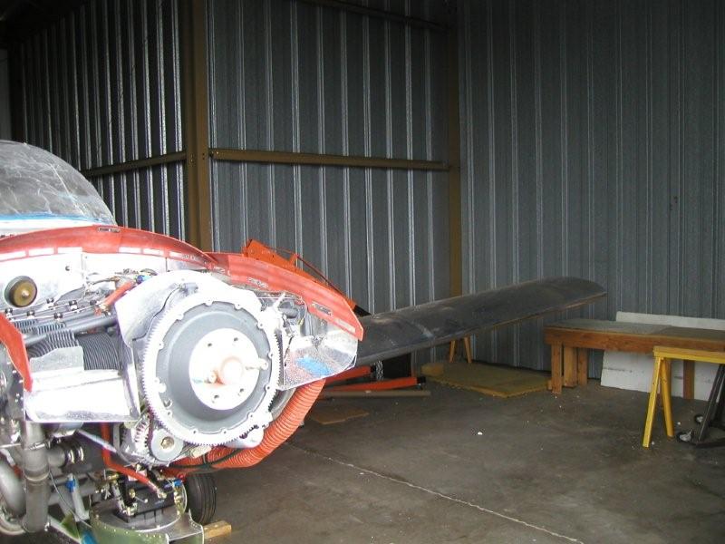

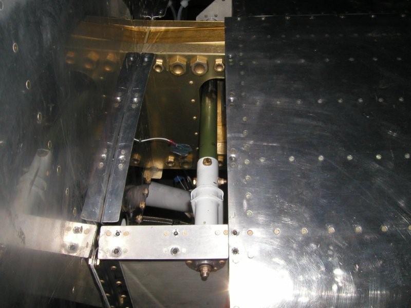

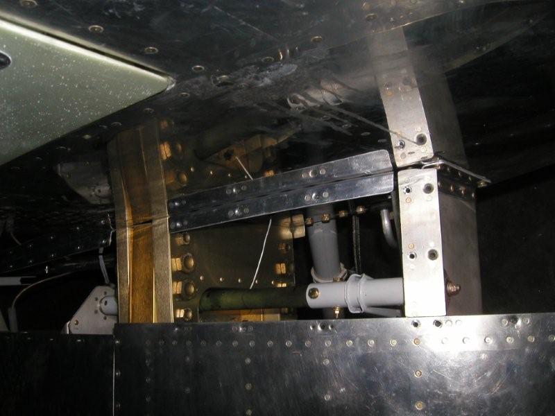

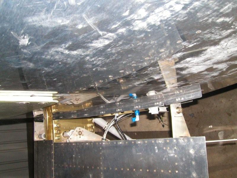

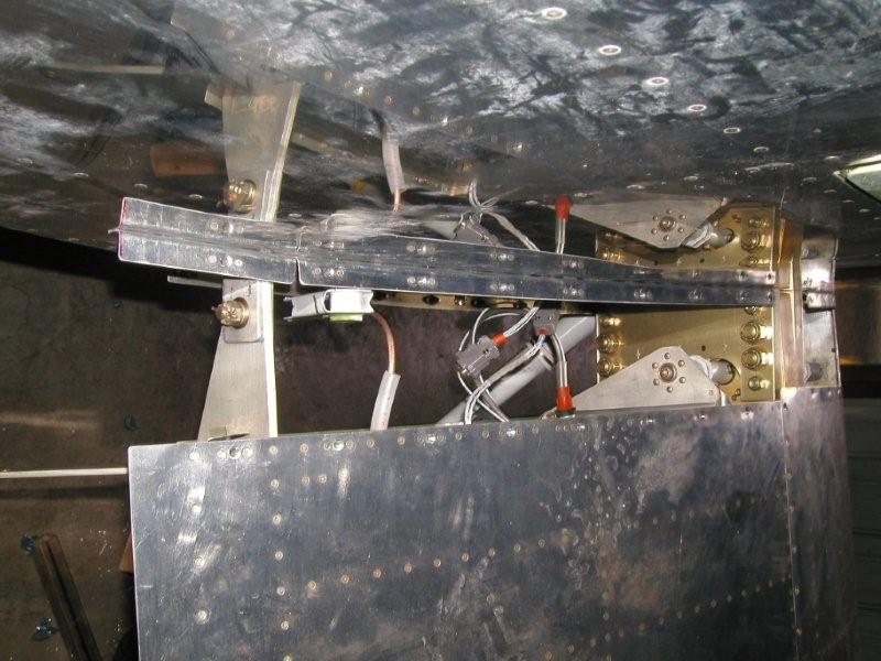

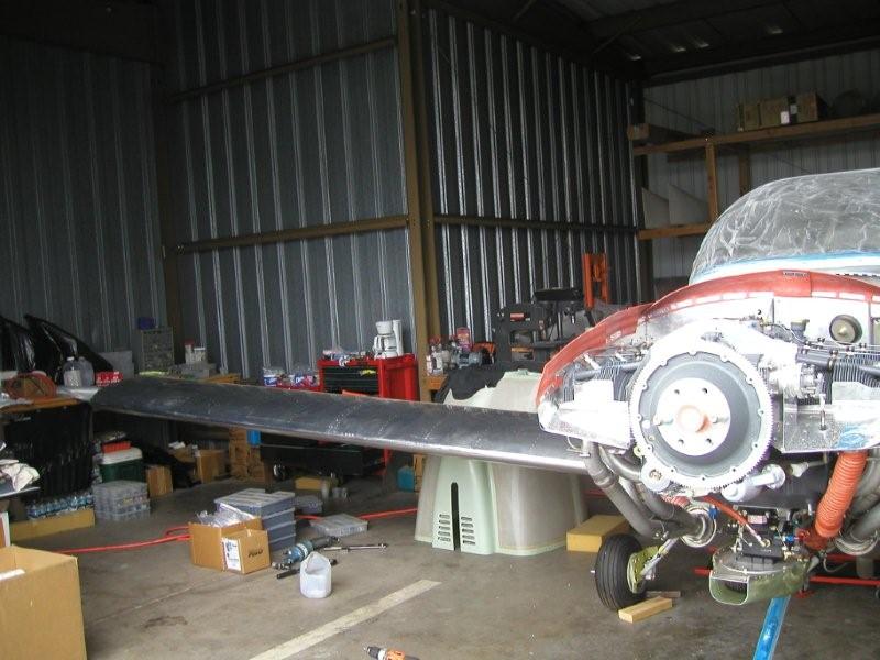

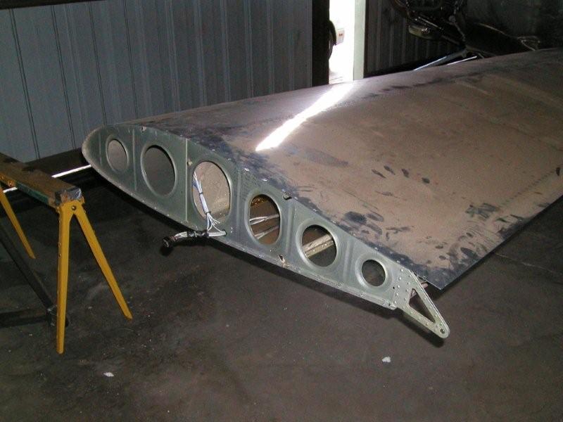

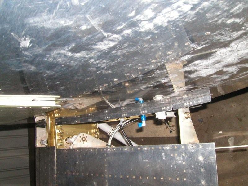

Another milestone. wings mounted for the final time. The F-1099 brackets are
called for about half blinds and half solids. The main over wing are called
blind but should be solid. That is the area where everyone will be stepping
to get aboard. All wing bolts in and torqued in about an hour. NAS close
tolerance bolts really tight left and easier on the right. Used LPS-2 for
lubrication the holes. Also the forward most top hole each side gets a solid
AN4704-5. The top bracket stops short of that hole but it is punched in the
skin anyway. It easily clears the tank attach spar.
