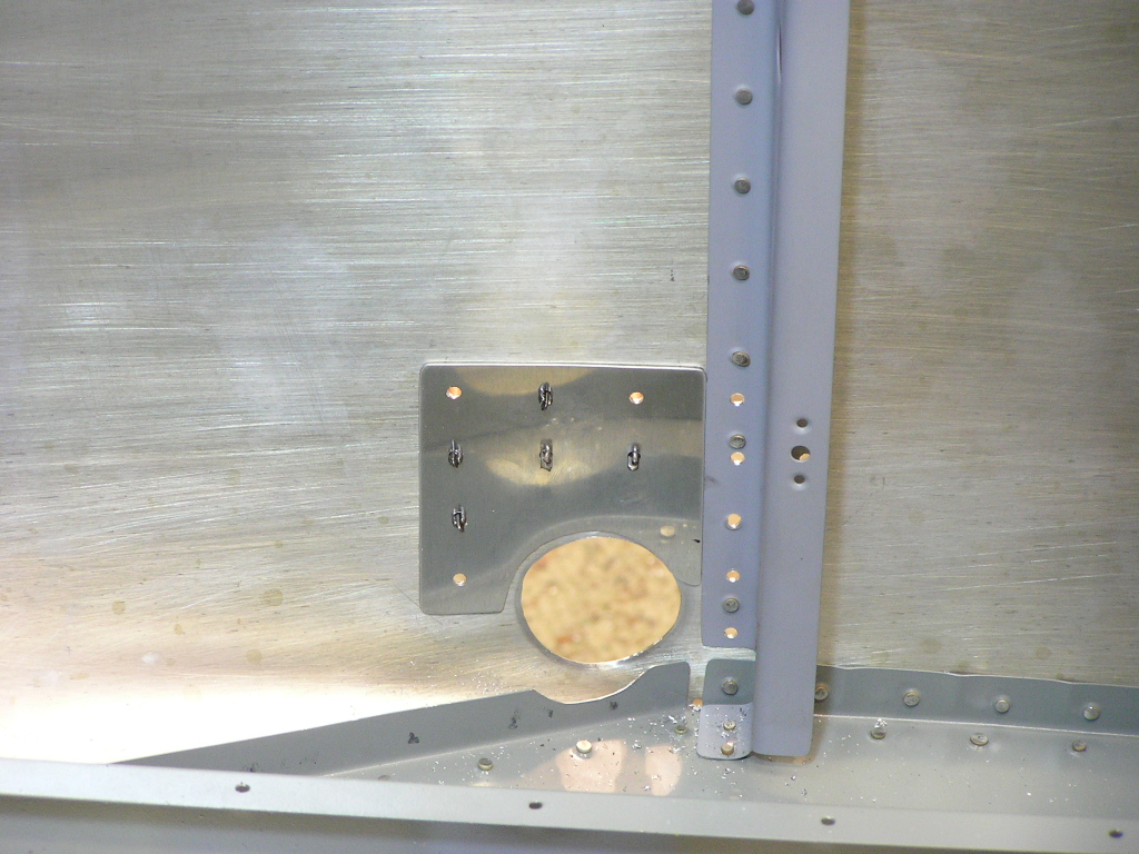

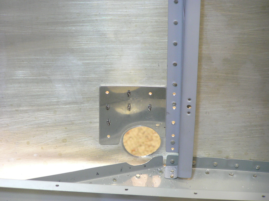

I reinforced the steps in my -9A with .040 inside the fuselage. I attached a photo. However, the cracks you guys are describing are sounding like weld failures.
