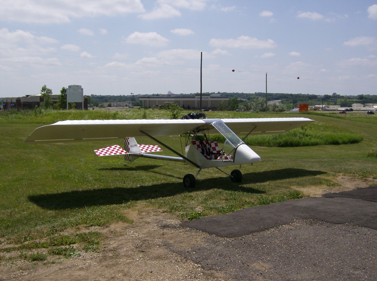

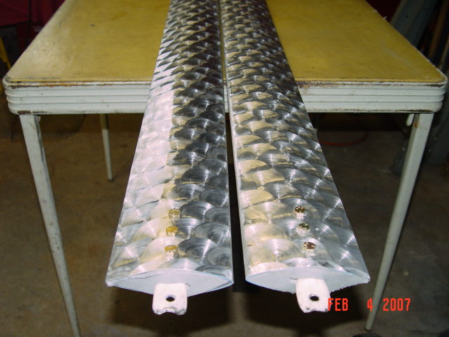

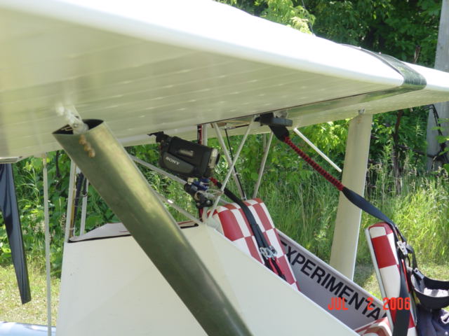

I made these Stream line sleeves....
I found a 18" piece of alum cheap....
Sheared it in half....
"Rolled" each 9" piece....24" Radius ???
Used a Break to bend them in the middle ( Knife blade )
Welded the seam....
Tight fit over my Lift struts....
Used 3 bolts on top ( Other bolts are 90 degrees )
They stopped my Lift Struts from vibrating in flight....
Gotta Fly...
Mike & "Jaz" in MN

That is some nice work ! I have never seen anyone weld aluminum that thin before Shocked Stopping the vibrations is reason enough to do that, did you get any speed gain with the stream line sleeves ?
Mike
