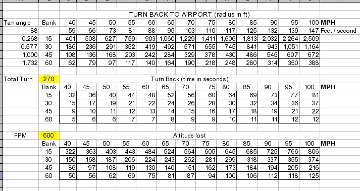

Thanks I will, however what I was attempting to duplicate is a engine
failure on take off. You know the routine, stay over the runway until you
have enough altitude to return. Any way, the education that I was attempting
was not skill, more like how much air did I lose with a 360. The dead stick
was the result of increased confidence in my planes handling since
tightening the elevator cables. Or cockiness which ever you prefer.

I'm so glad you have cleared up this issue for the list. For years
I've been telling other pilots that maintaining constant airspeed in a
turn, even steep turns, while descending at idle/no power increases
descent rate but not the stall speed. I discovered this myself while
practicing the "turn back to airport" practice at safe altitudes with
sudden loss of engine power. I do this on every "new to me" airplane
so I know how much time and altitude it costs me to do that. Once that
is determined I know before take-off what AGL altitude I need as a
minimum to even consider turning back in the event of a power failure
during initial climb. The slower your airspeed (but safely above stall
speed/aoa) the faster you can turn with least altitude loss. As you
noted, coordinating the turn is very important to avoid nasty surprises.
I've attached an image of a table I created showing the time to make a
270 degree turn at various bank angles and airspeeds. It also gives
the amount of altitude loss assuming a 600 fpm descent rate.
Thom in Buffalo
