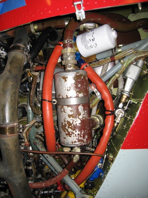

david(at)mcgirt.net
PostPosted: Fri Jan 18, 2008 6:25 am    Post subject: ADC Oil Filter Reply with quote
Richard,
I have a Yak52 TW w/ the ADC installed, I will include a link to a
picture, and would be glad to take more if needed. I have been pleased with
the unit, although the one drawback is the size ( it can get in the way )
I like being able to pull the screen every oil change, and KNOW what is
being caught, not send a spin off to someone, or just hope for the best..
But that is just my opinion..
http://picasaweb.google.com/dmcgirt/OilShutoffYak52TW/photo#5155342296077646
034
David

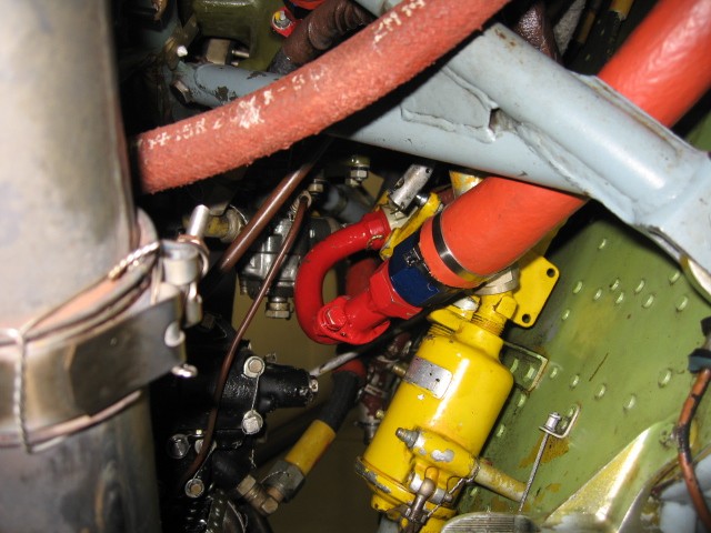

PostPosted: Sat Jan 19, 2008 10:10 pm    Post subject: Re: ADC Oil Filter Reply with quote
I have a Airwolf filter on my 52. It is located before the cooler to keep the particles from entering the cooler as Airwolf recommends. Also Airwolf recommends the oil should be the hottest for the filter to flow and clean at max output and not block the cooler flow. The output pressure of the scavenge pump is not that high and needs to keep up the flow with the min pressure needed so care must be taken to assure the relief valve in the filter can open and not block the oil cooler relief valve and damage cooler. Cooling the oil and then forcing it through the filter is not as good of a idea as hot oil flowing through the filter.
Dale

Dale
Joined: 30 May 2007
Posts: 178
PostPosted: Sun Jan 20, 2008 9:05 pm    Post subject: Re: ADC Oil Filter Reply with quote
Don't remember right now what the # is but all you need is the adapter and a bracket. It is not the Gorilla but a standard with large fittings. Airwolf sells a kit for the Yak but the hoses and clamps are too large and useless as far as I am concerned adding extra cost, as I remember you need -10 hoses and fittings and Airwolf sent -12 with slip on hoses and clamps. There is only 15 psi on the output. You might well make your own kit up using a different spin on filter plate also. The Champion filter has the correct bypass setting for what you need. I originall set all the information to Airwolf as they requested so it could be passed on. You will need to make your own fittings and the photo's I included show how I went from US back to Metric using the same hoses and brackets. The scavenge line from the engine needs to be angled back slightly to clear the engine mount. In the photo it is hard to see it so before finish welding I suggest a trial fit with the hose assemble complete. If anyone is truly interested I can do a complete How To. It seems every one has there own idea how to do it. I have 140 hours on my install.

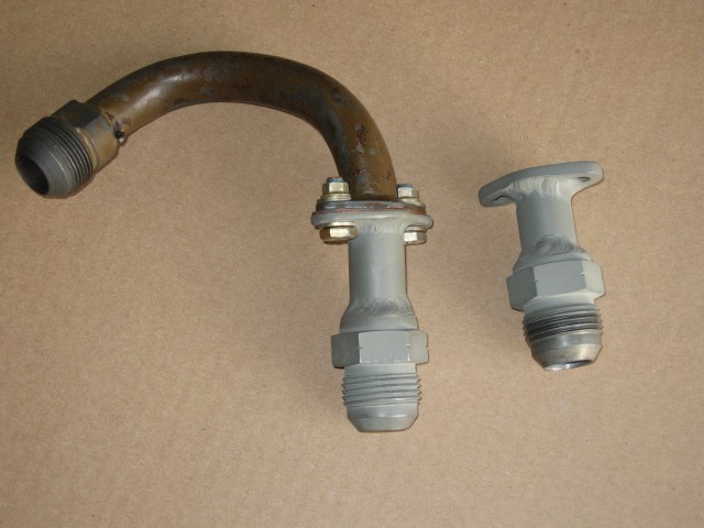

PostPosted: Mon Jan 21, 2008 8:21 am    Post subject: ADC Oil Filter Reply with quote
Actually, with the ADC you can install a -12 hose with out any welding. All
you need is two fittings and you can convert it to US hose. I have the
fitting and I think Cliff Coy has them too. I have pictures if anyone needs
them.

PostPosted: Mon Jan 21, 2008 9:01 am    Post subject: ADC Oil Filter Reply with quote
Both ADC and Airwolf supply -12 fittings with their kits. That is the
correct size for the Huosai or M14 installation and virtually identical in
size to the original hose. ADC supply either metric or AN fittings for
installation with complete hose assemblies rather than hose & clamp style.

wlannon(at)persona.ca
PostPosted: Mon Jan 21, 2008 6:25 pm    Post subject: ADC Oil Filter Reply with quote
Hi Dale;
I honestly don't know the answer to that though some possibilities come to
mind.
1. Could be I have made an incorrect assumption that the Yak is the same as
the CJ in this respect. Would not be the first time!
2. I have not installed an Airwolf unit, just the ADC's and since I make my
own hose assemblies have not had occasion to order hose with the units. Any
possibility that Airwolf supplied the hose size for the R1340 (-16) rather
than -12??
I checked your photos but can not determine hose or fitting size. The hose
they sent you should have the designation on it. If it is Aeroguip 303 or
Stratoflex 111 (MIL-H-3794) it will show the size as a dash number
(-10, -12 etc.). If it is MIL-H-6000 it will show a fractional size (5/8,
3/4 etc.). The approximate actual ID for the -10 is about 1/2" and for
the -12 about 5/8".
