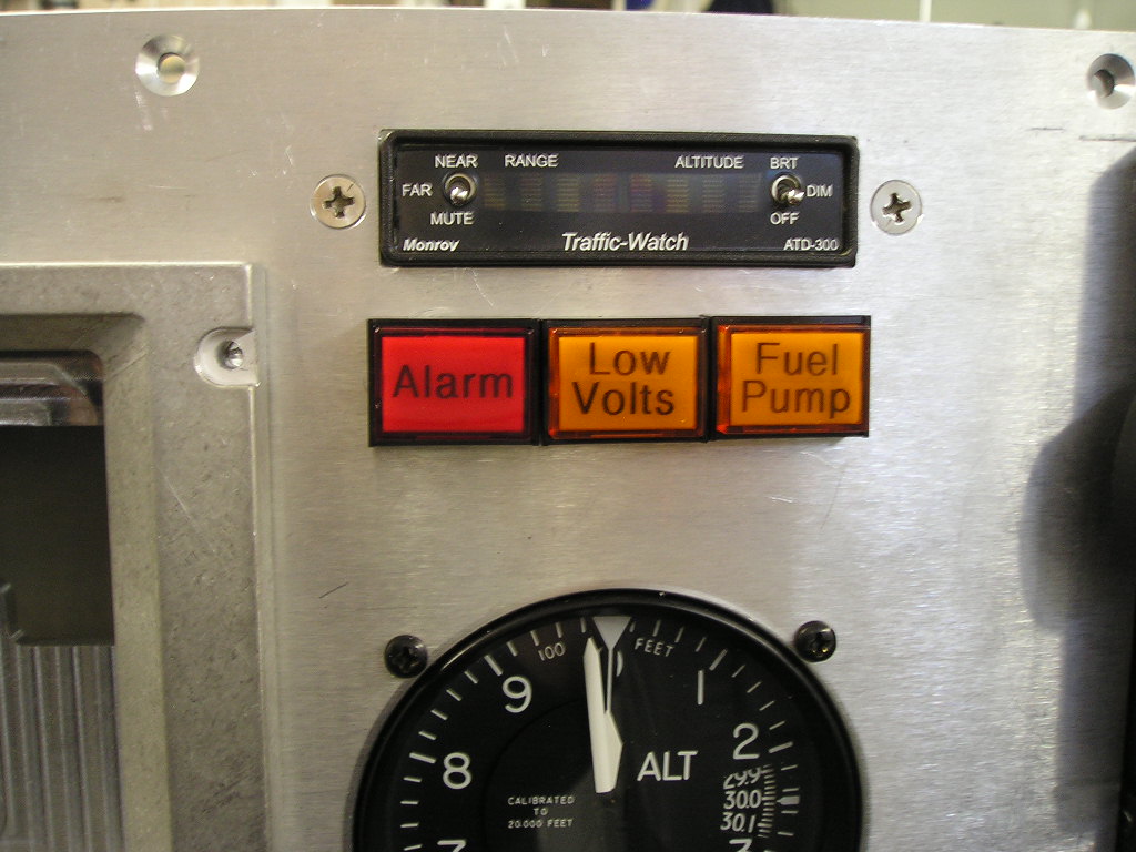

Got a picture?
Why do you need 12 enunciators? Doesn't the AFS do this already?
I did just a few using legend lights from aircraft spruce. I modified some spare bulbs I had already and made them into led bulbs. You can also buy pre-made led bulbs in this format. works good. Attached is a picture of the final result.

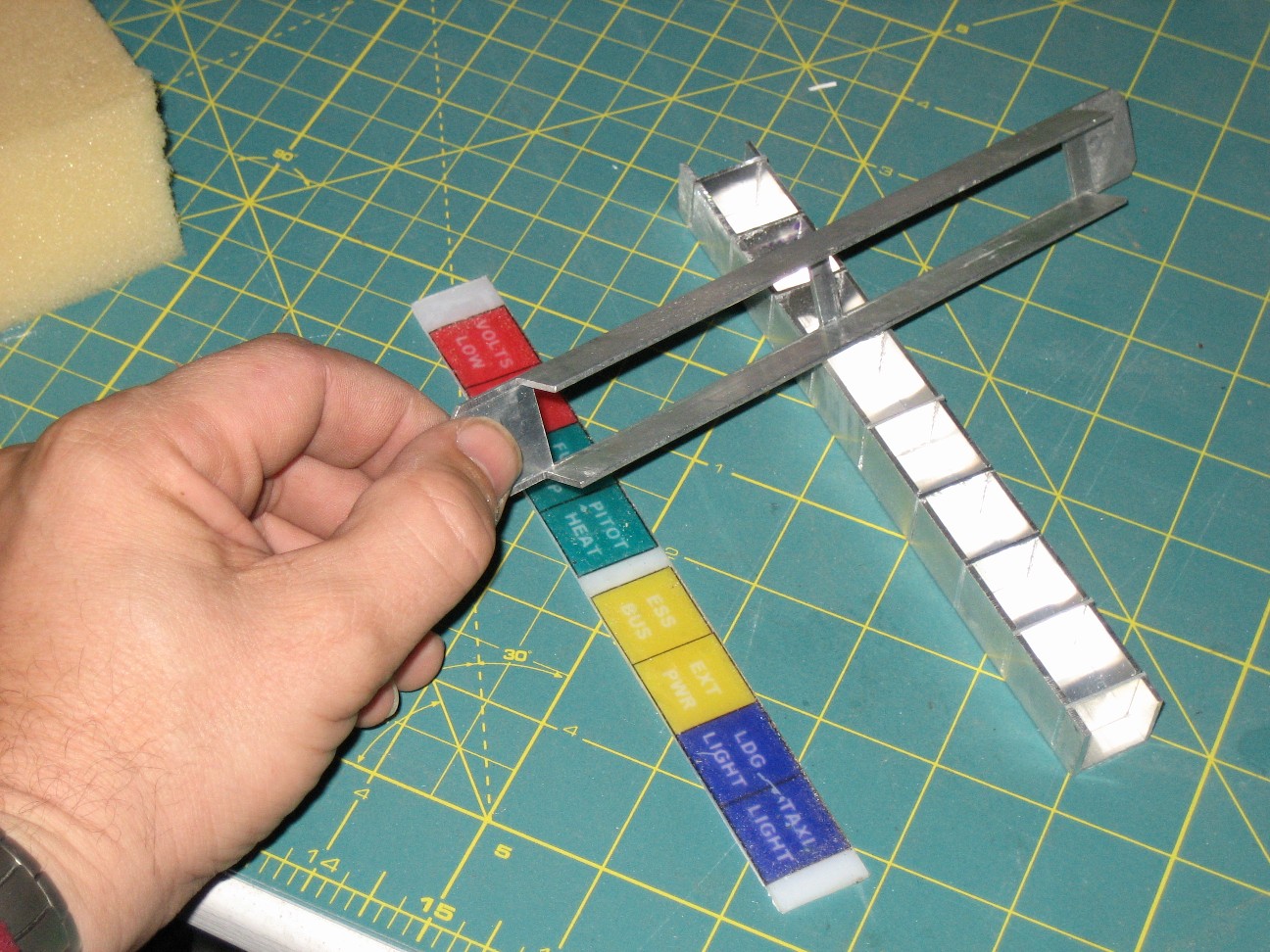

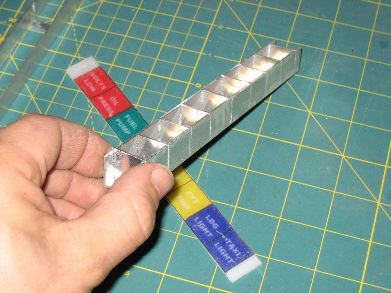

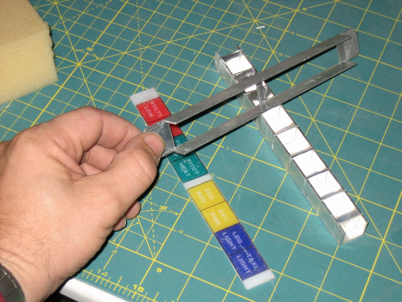

Mark Phillips in TN
Joined: 10 Jan 2006 Posts: 431 Location: Columbia, TN
Posted: Wed Jan 09, 2008 9:15 pm Post subject: Question about Annunciating Lights |
Here's another take on rollin' yer own:
http://websites.expercraft.com/n51pw/index.php?q=log_entry&log_id=5126
Click on fotos for bigger view and Next Entry>> for more info (several pages) including wiring diagram, part #s etc...
From The PossumWorks in TN

zk-vii(at)rvproject.gen.n Guest
| Back to top |
Mark Phillips in TN
Posted: Wed Jan 09, 2008 10:36 pm Post subject: Question about Annunciating Lights |
In a message dated 01/09/2008 11:46:52 PM Central Standard Time, zk-vii(at)rvproject.gen.nz writes:
| Quote: | | Just another possible source of ideas. |
Oh, yeah- make mine look like somethin' outa some chickenhouse in Tennessee!!
Awesome work, Carl- I genuflect profusely!
Mark - do not archive

bferrell(at)123mail.net Guest
Posted: Thu Jan 10, 2008 6:19 am Post subject: Question about Annunciating Lights |
I made my panel out of Honeywell microswitches. It's not really a cheap way,
but the results are nice, and it's fairly straight-forward, with "dead face"
(labels so you KNOW the lamp is out, because it cannot be read unless
illuminated from behind). I also built a push-to-test circuit.
http://www.velocityxl.com/Electrical.htm
(just the pictures)
http://www.velocityxl.com/annunciator.JPG
http://www.velocityxl.com/press_to_test.JPG
http://www.velocityxl.com/IMAGES2/GRT3.JPG
I bought mine from these folks http://www.fmw411.com/
Brett
