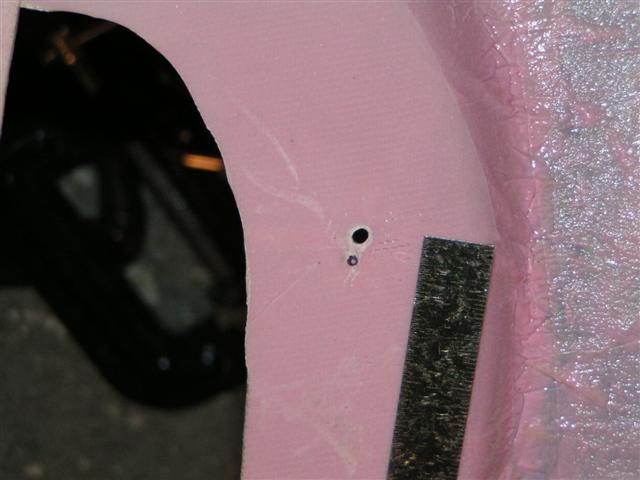

I was wondering if any one has had a problem with clecoing the cabin door shells together with the 4 alignment holes at each corner of the window cut out. If I cleco the bottom corners the top corners miss by about a 1/4 inch. (see photo) They seem to almost line up fore and aft but are 1/4 inch off up and down. I tried clamping from the bottom of the window cut out moving up thinking that it might be a tight fit and all but that didn't work either. I could cleco the fore and aft door to fuselage alignment holes woth no problem too. I have the pink colored finish kit doors and cowling if that makes a difference.

I had the same problem 10 days ago. Called vans to confirm the issue and just used the lower 4 holes, 2 in the window frame and 2 for alignment to the fuse. All looks good so far.
I just finished the 8 hours of sanding and fitting to get the doors fit in the fuse, but they fit fine now.

We have seen a lot of variation using this method. We have found the best method to use is find out how much space you have in the opening, then tape spacers in around the cabin top in the door opening, then put your door in place and use a hole finder to drill the hole in the fiberglass. YMMV, but we have noticed a fair bit of inconsistency.

I had the same issue. Just used the lower holes (they matched). There's a lot of material to cut off after gluing the halves together, so it shouldn't be a big issue if the fit isn't perfect on the top holes. Pretty rough stuff.

Thanks for the replies. I guess I'll forge ahead with just the other 4
