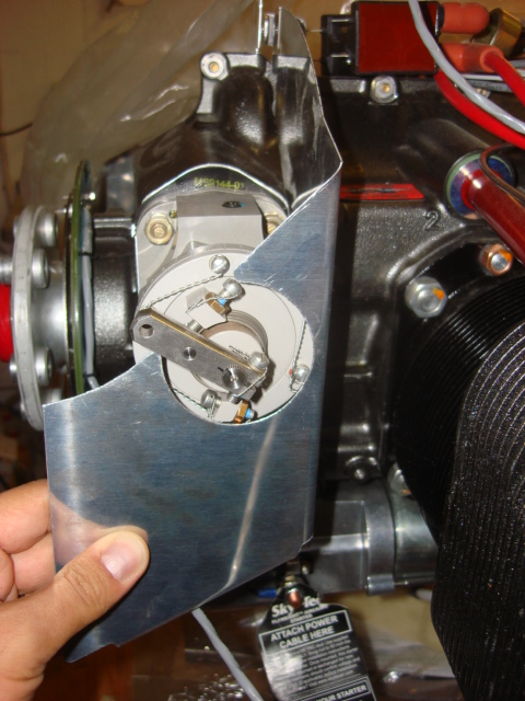

Hello,
did you guys cut the CB-1001a front baffle in order to fit the prop governor through the cut out hole?
Michael

Yes, a little. You don't want to remove too much, though, because you
don't want to lose your cooling air through that hole.

Yep, try to trim in the shape of the governor, so that the ramp
kind of form fits to the governor's needs. Leave enough clearance
though to guarantee the lever and bolt won't hang up.
Then, once you have the slot there and it's wide enough, glass in the
ramp ends so the air can't flow up through that area and under
the ramps. You should be able to seal that area pretty well,
even with the clearance hole. The sealing of the air ramps is
a big key to getting things done right.

You bet--seems that there is no other way.

epoxy at that time, but it did end up sealing well. In short,
when you put the curved ramps on the cowl, you now have a tunnel
for air to go from the high pressure top side, out to the low
pressure part of the cowl outside of the baffling, without
ever traveling through the cylinders. You can lose a major amount
of air before it even gets near the cylinders. So, just sealing
it up good fixes that problem.
