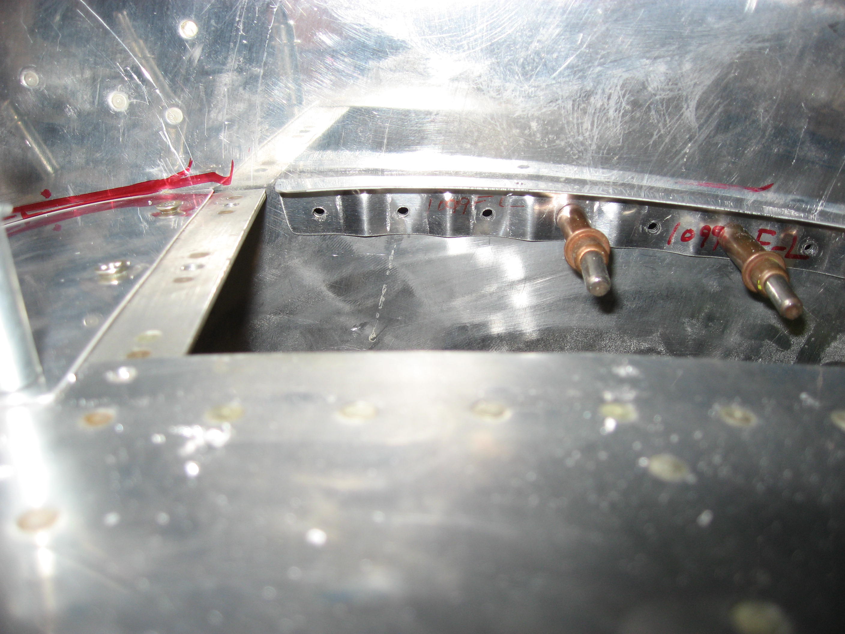

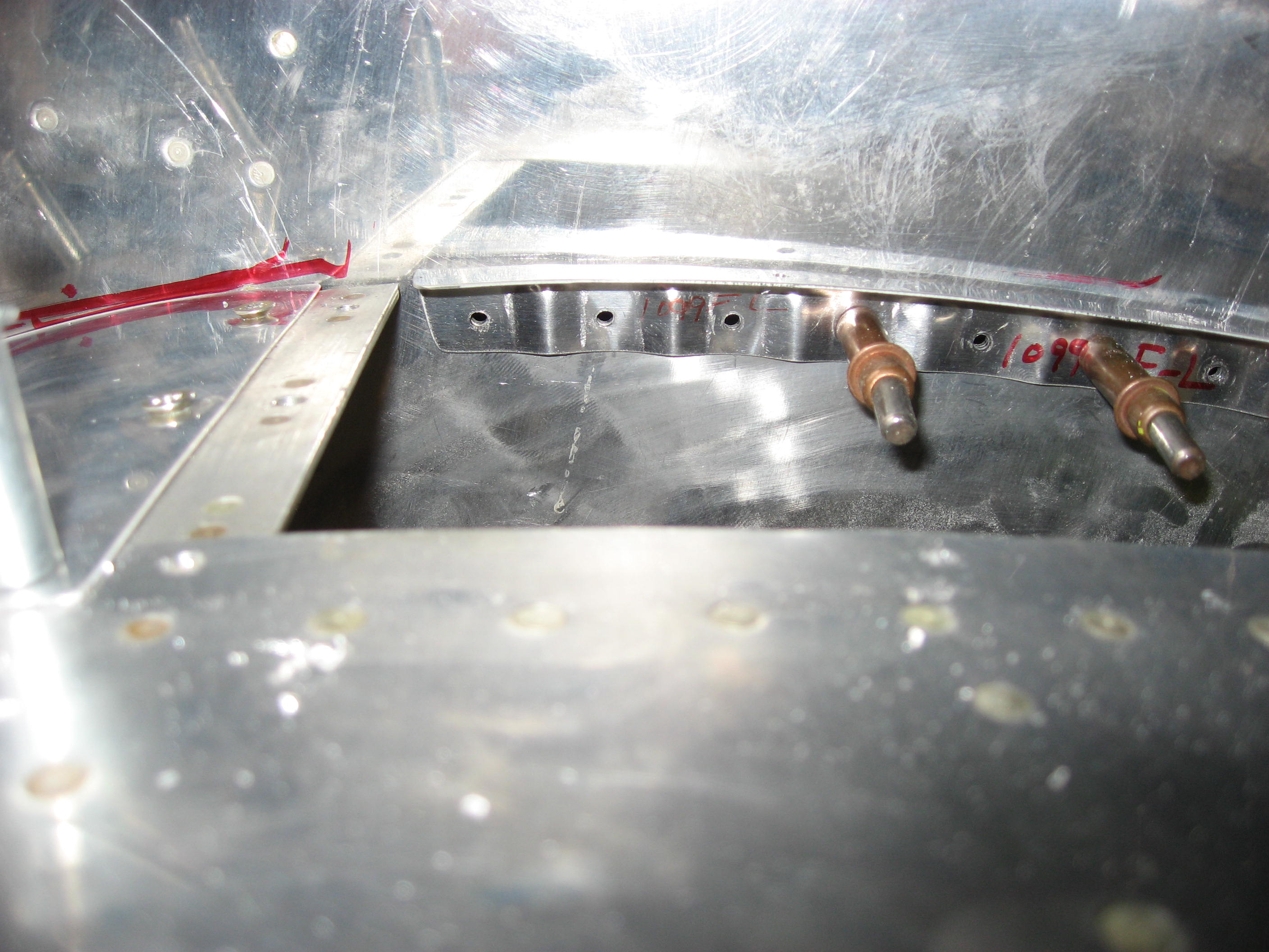

. The top flange is .2 inches high when clecoed in place. This part came with the QB fuselage #8 of March 2005. When we queried Vans, they concur that the bend line for the part was wrong. They are sending a new part. while waiting I borrowed a replacement part from another builder on my field and the part fits properly. after installing the F-1099F-L, the F-1099E-L and F1099H-L looked wrong; we replaced them all, including the F-1099G-L and they now fit properly. If you are fitting the wing fairings and get a fit like we did you may have a bad set of fairing parts. In addition Van's aircraft has a single screw in F-1099G-L and -R even though the plans don't show a need for one there. One other thing, the picture as shown in 44-2 figure ! does not match the view of the part; the second part we received works correctly so we assume the drawing is in error.
