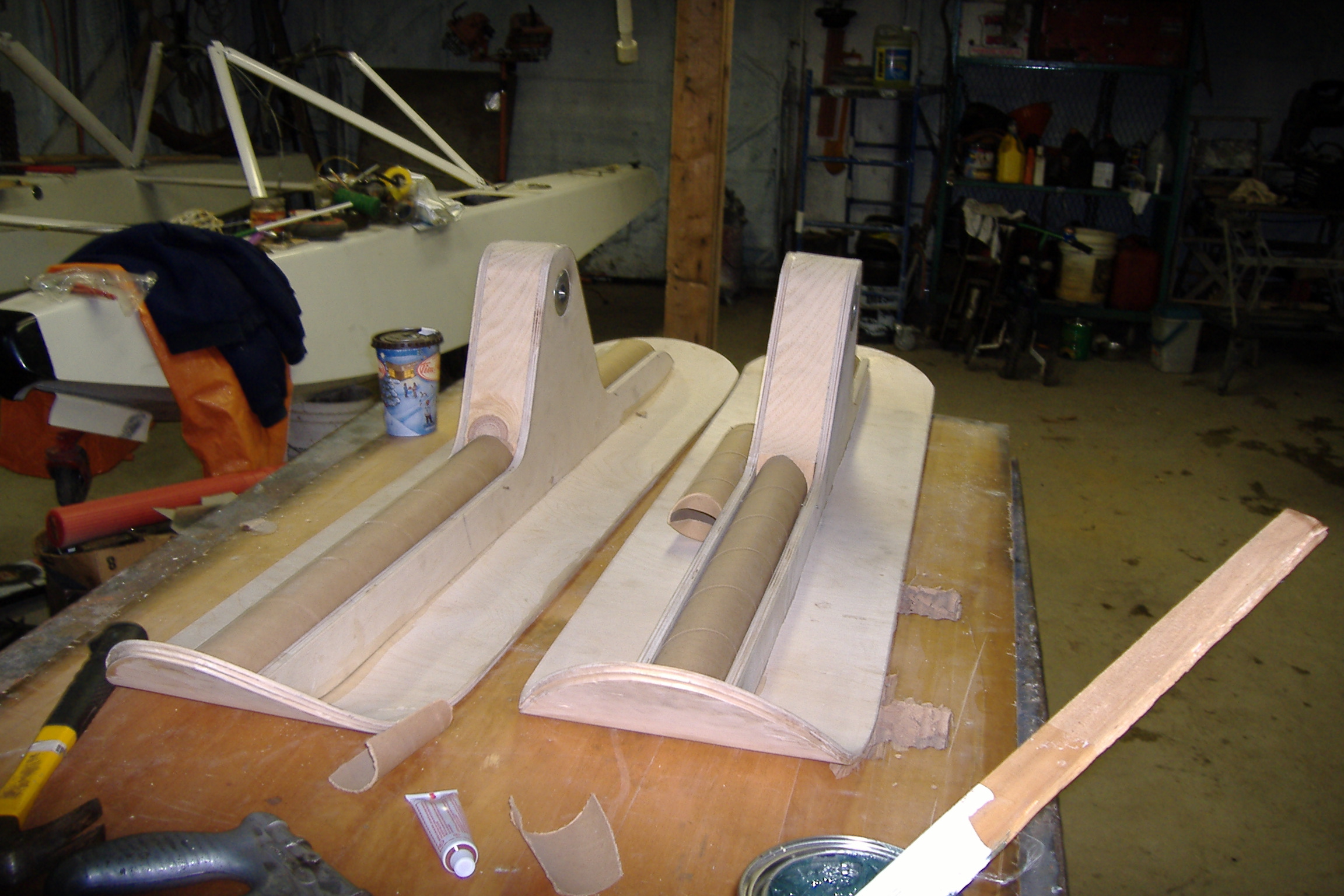

Lynn for reference use,
I had a friend build a pair of skis last year out of plywood and over laid with glass at my shop. When he brought them out I said I think it has a pretty steep angle on the nose of ski but he thought it would be ok. Well he finished them and they looked great. Took him an hour to put them on and rug the cables and bungees but when he started to taxi the noses dug in. Took him 2 hours to dig the plane out and get back to hangar.
Not to run his nose in it I taxing mine repeatedly through his ruts and where he got stuck to show him that the ones that I have did in fact work better and not dig it with a shallower tip angle.
I am just pointing out how critical this was to him and hopefully as other have pointed out to "help others gain form the experience of others" with the use of this forum.

Mine now have a 2-stage angle on the front...the recent 8° bend (I
call it the Mother Nature bend), and the original approx. 45° angle.
This allowed them to get through the snow rather well, with the 12-
inch width of the "shoe." Were his narrower than yours? Was his tip
bend short in height? How about the length from the axle pivot to the
tip? A shorter dimension here could affect his ability to climb over
the snow, I would think, especially with a steep tip angle.

I dug out a pic of those skis i mentioned above.
I can tell you that these skis did not work very well as the tips just dig, dove whatever with that tip too steep.
Wooden ski with tip too steep
www.cfisher.com Kitfox

I see what you mean....they look way too blunt to me. It looks like
they are no more than about 4" high at the tip, and too steep, like
you said. I think I made mine about 6" high at the tip, and much more
pointed. The recent encounter probably gave me another 1 1/2 to 2"
more height at the tip, and they seem to like the deeper snow now. Of
course all of our snow is totally gone now, so I'll have to wait
until more falls, or head toward the upper part of the state to find
snow.
