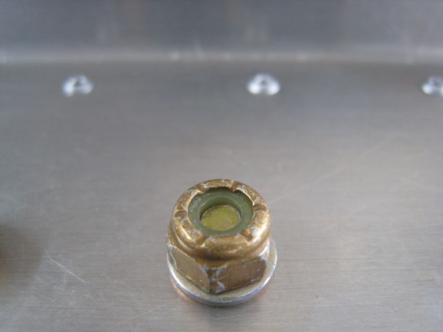

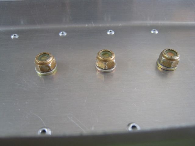

On my QBK the central pedal bearing 6B9-4 came installed along with the
rudder pedals. I was looking at the lock nuts underneath the fuselage on the
three AN3-15A bolts. Normal practice (and the Zenith construction standards,
page 31) call for a minimum of two threads to protrude beyond the nut. On my
QBK the end of the bolts do not protrude at all. In fact the tips of the
bolts are probably recessed by two threads. I don't think any threads engage
the Nylon portion of the lock nuts. Although an AN3-16A might meet the spec
I think these three bolts would have to be changed to AN3-17A to ensure
enough length.

Must change...
Did you get the hole gauge ???
SW
