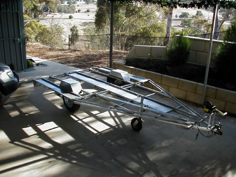

PostPosted: Sun Jan 07, 2007 4:25 am    Post subject: Re: Dimensions of CH701 Reply with quote
Ken, Attached picture of my 701 trailer, built before the kit arrived and used to haul the kit box 60 km home.
If you want the plans, I can email them to you. Cost me $950 Aud to build
Steve in Perth
