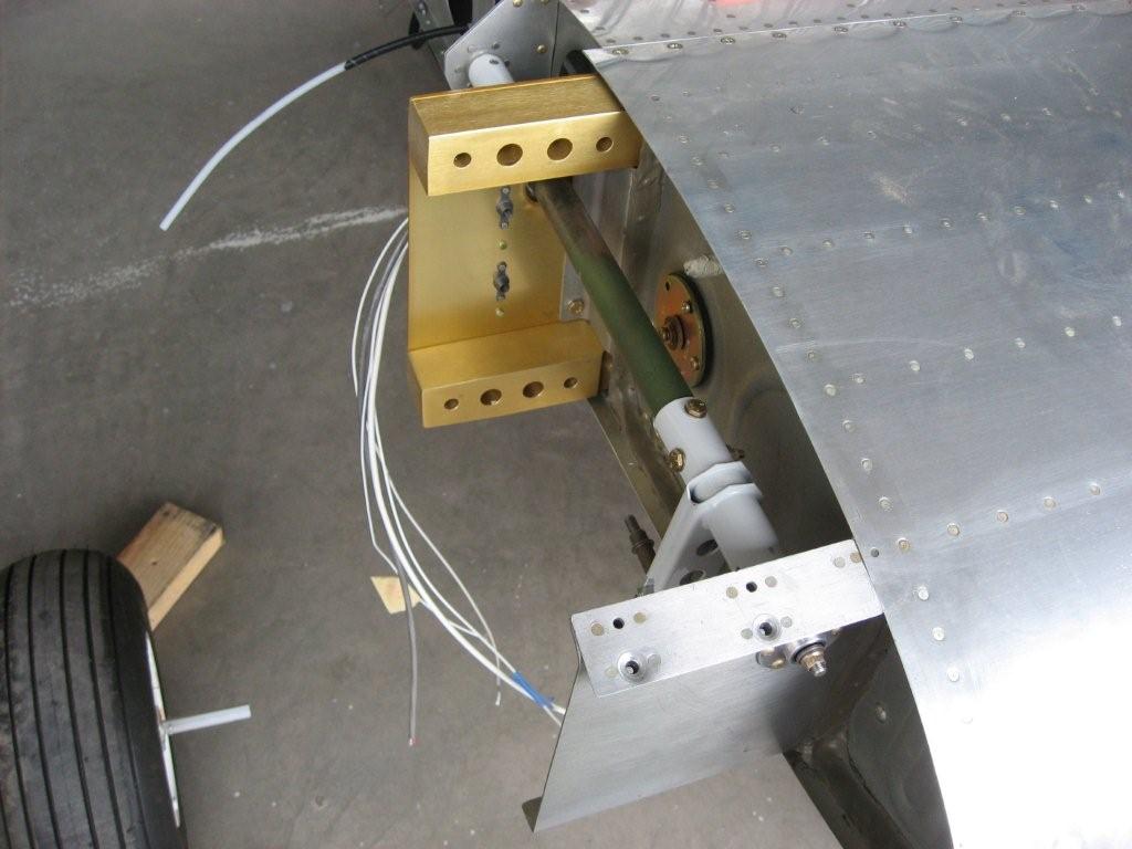

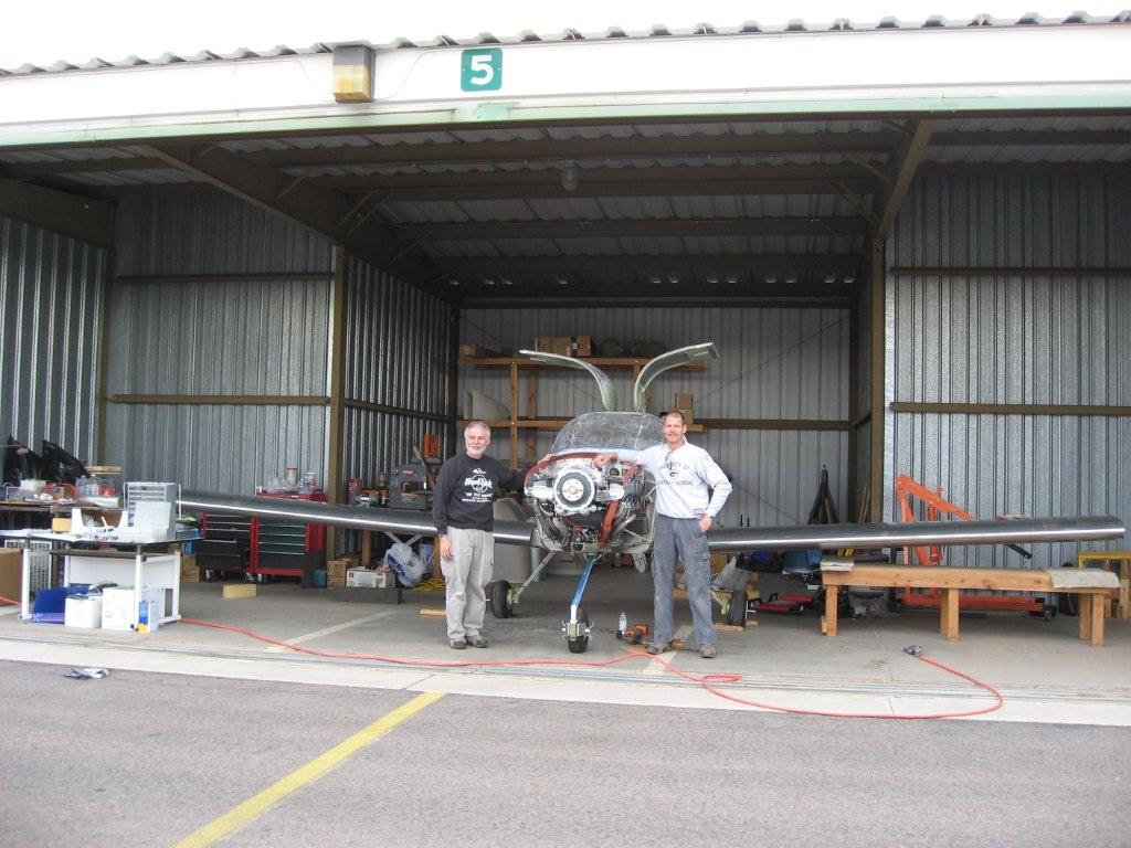

Its always a question whether the wings will match the fuselage when both
are QBs from different batches. we used grade 8 3/8s and 9/16s sizes. we
also had two long 3/8s of normal variety. We found the normal hardware bolts
to be about .369 and .559 respectively. The grade 8s were .373 and .559. The
NAS bolts were .373 and .561. Buy the ACE bolts and use a band saw to cut
off the threads; then grind and polish the ends with the grinder and
scotchbrite wheels. We lubed with LPS2. The actual time to install each wing
was about 5 minutes but the time to trim and install the fairings totaled
about 4.5 hours. That was after my pre prep of a couple of hours pulling the
hardware and tools necessary from the kit trays. Thanks Deems and Paul and
Tom for the extra muscle.
