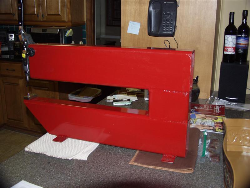

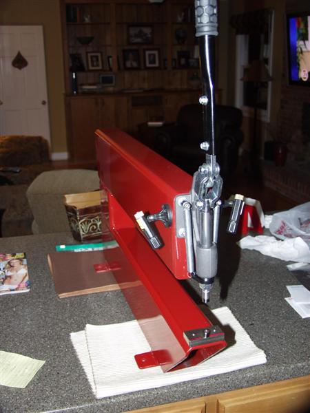

I just finished this today, plans and head unit from sales(at)experimentalaero.com -- took about 5 hrs. to fabricate, align, weld, paint. The steel came from a local scrap yard and is 1/4 instead of 3/16, so it's about 70 lbs. -- and since it is heftier, I made the throat a little deeper.
I'm helping a friend build his RV-10 (wish we had had it for his!), and just got my tail section kit for my own.
I added the laser X&Y axis guides ($5 ea. at Harbor Freight) to pinpoint where the die is to help line up the hole. It's VERY sweet! Just thought I'd pass on the laser thought.

To the center of the die is 23". That just happened to be how the material I had to work with turned out -- I truly believe I could have added another 4 or 5 inches with no problem whatsoever. This thing is a monster, but solid as it can be!
I was actually looking for a laser pointer with a single dot and I was thinking of activating it with a limit switch on the ram so it would only come on when needed. I couldn't wait and found these laser markers at Harbor Freight (Central Machinery, Laser Marker, item 93242) for $5 apiece. They attach with magnets, stickey pad, or screws and have an on/off switch. Since they form a line instead of a dot, I got two so that they make a cross hair right over the female die on the bottom. I read that some didn't like the male die on the bottom cuz it scratched the surface trying to line it up with the hole -- this way there's no scratch and easy alignment every time.
