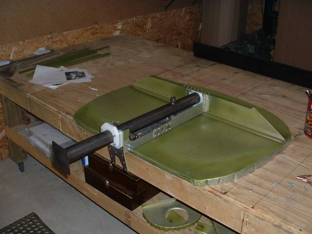

Wayne-
I believe the material is Delrin. Larry offers a machined set of bearings for an HDS, which I installed. You can get by with simple flat stock ala what is provided in the XL kit, but Larry beefs up the critical areas while keeping weight at a minimum. >From the attached picture, you can see that pulling the engine is going to be an advantage to getting access. From experience installing with total access, you're only going to want to do this once. Don't be penny wise and pound foolish.
If you have as much snow as we have, at least there will be plenty of winter for you to get the job done! The bright side is, you won't have any slop problems when it's over.
Bill
