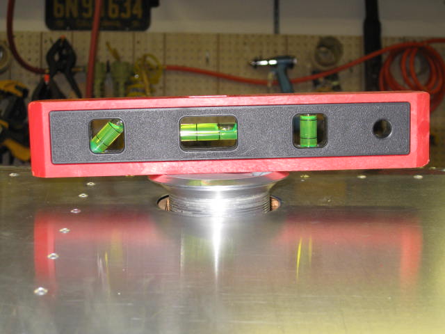

Hello all,
I have seen some posts on this topic a while back and hesitate to start a new thread, but wanted to see if anyone has developed any new techniques for leveling out their fuel filler neck on the tank. See the attached picture .. one side is about 3mm higher than the other. I know one lister was able to correct this by hammering down one side with a solid piece of maple. I tried this carefully, but the threaded neck just seems to rebound to it's original out of level position. Any experience in solving this is appreciated before I give Zenith a call tomorrow.
Dave Gardea

PostPosted: Thu Jan 03, 2008 4:14 pm    Post subject: Fuel Filler Frustration Reply with quote
Dave,
I just finished dealing with the same problem, and also tried to tweak the neck. Not much luck for me either! My fix was to use small pieces of cork strip to build up the area between the tank and the skin on the side of the gap (right side on your photo). When I tightened the filler neck, that side was held higher while the remaining area was compressing normally. The gap disappeared, for all practical purposes.
Good luck!

PostPosted: Thu Jan 03, 2008 5:53 pm    Post subject: Fuel Filler Frustration Reply with quote
Hammer harder! (Not that I really liked that method.) I used the hammer technique and then added quite a bit of cork to try to make my filler flush.
Michael in NH

PostPosted: Thu Jan 03, 2008 6:07 pm    Post subject: Fuel Filler Frustration Reply with quote
Dave: I had the same problem, only mine was much worse on one side.
After careful consideration I ignored all advice and filed the threads off
the filler necks until they slipped easily into the tank in a perfectly
level position (they had a beautiful machined thread), bought some goop
guaranteeed to seal gasoline systems and gooped them on.
They now look perfect.
My solution may not be for all but it worked.
Mike

PostPosted: Thu Jan 03, 2008 6:52 pm    Post subject: Fuel Filler Frustration Reply with quote
That is exactly what you have to do... When you build up the cork it forces the tank metal to conform and it lay flat as a pancake just be careful because the more you put the filler cap in and out it seems to get harder and harder to take out. The point is you will have to play with it to get it just right.

PostPosted: Thu Jan 03, 2008 7:35 pm    Post subject: Fuel Filler Frustration Reply with quote
Dave,
I used a hardwood block set flat on the filler neck top, and
whacked it as needed with a heavy mallet. I had to hit it hard on the high
side, but in a few minutes, checking progress with a straightedge, problem
gone. I had th tank supported on carpet and foam. The other issue with the
earlier tanks that have filler neck welded on top of the tank, is getting
the filler to sit low enough that the lid will screw in far enough to meet
the skin. The crude hammer method helps that as well. Just don't "test fit"
the threaded section without applying anti sieze to the threads first, they
will lock up if you aren't lucky.

PostPosted: Thu Jan 03, 2008 8:47 pm    Post subject: Re: Fuel Filler Frustration Reply with quote
I'm the guy who hit it with the maple block. I placed more pictures on picasaweb to show how I did it.
http://picasaweb.google.com/ron.lendon/FuelFiller
Aluminum has a lot of springback, it takes quite a lot of movement to get it to take a set. I whacked it a few times before it was where it needed to be and it didn't deform the bottom of the skin. The entire wing is supported on 6" Styrofoam blocks when this operation was performed. I just Clecoed everything in place and just hit it where the high spot was.

PostPosted: Fri Jan 04, 2008 6:05 am    Post subject: Fuel Filler Frustration Reply with quote
Dave,
If I remember correctly, I reinforced my circumference of the fuel filler neck area with the cork used on the exterior of the tank. This allowed mt to put a slight clamp load on the assembly and it all seemed to fit together well.
Good Luck.

PostPosted: Fri Jan 04, 2008 6:39 am    Post subject: Re: Fuel Filler Frustration Reply with quote
I had already closed my wings when I found out how poorly the fit was in this area.
Here's how I solved it: http://picasaweb.google.com/Patrick.Hoyt/FuelTankFillerFix
I've noticed Zodiacs at fly-ins where the builder just left it alone and lived with the big dimple, but I didn't want that on my airplane.
It's not hard to fix, and can easily be done "after the fact".
One other solution that I've seen on Zodiacs is where the builder fabricates about a 6 inch circle of sheet metal, with a hole in it through which the treaded bushing is inserted. Think of a "doughnut" shape that covers the whole area.
