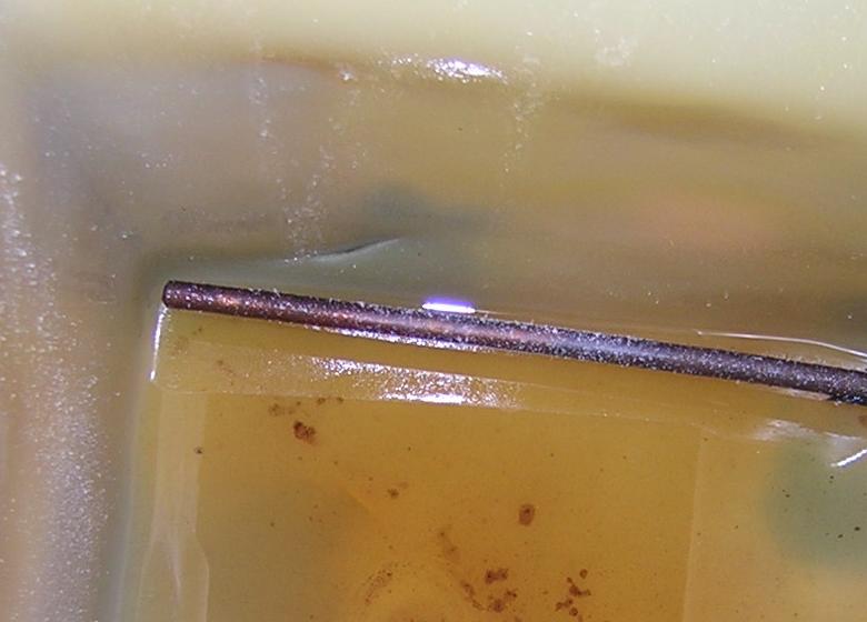

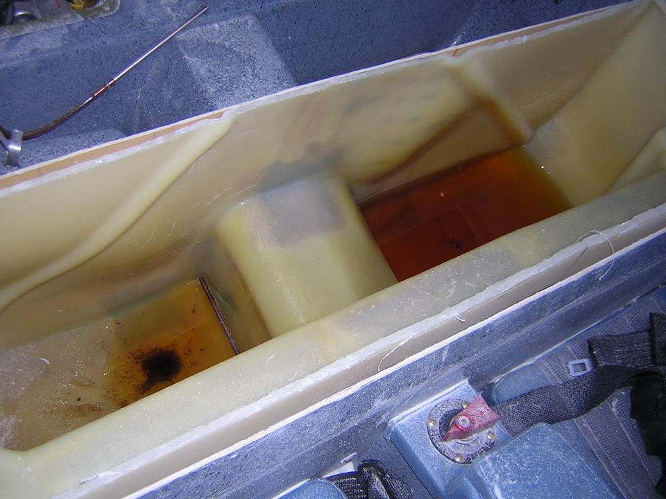

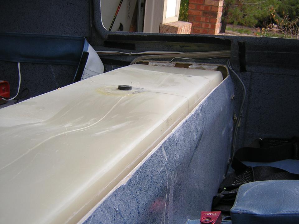

Old business: I have tore into the top of the cockpit seatback to get at
the gas tank to pull it out because of the crack. Once the top was off what
was present was slightly disturbing. We have our extra support pads to
keep the tank from pooching into our spar cavity and interfering with the
aileron belcrank rod. Every interior surface looks like that. The top of
the tank is vavy from expansion and the back surface exhibits the same
condition. In all cases flat surfaces of the tank are stressed and buckled
because of the expansion. You just don't see it unless you take the lid
off.

Check some photos of the tank and the crack attached.

Thanks for sharing your frustrations w/ your fuel tank and passing on
your thoughts on the issue of cracking....sobering thoughts and pixs
indeed. A couple of questions:
- When you say "extra support pads", do you mean that you installed
some pads in addition to those called for?...If so, can you describe
them?
- At some point, I seem to recall that the supplied tanks were changed
in some way to eliminate or reduce expansion. When did you purchase
your original tank? Do you know if you have one of the earlier or later
versions of the tank?
- Do you attribute your tank's failure (in part) to any extreme
temperature conditions which it may have been exposed to in your part
of the world?

hagargs(at)earthlink.net
PostPosted: Mon Dec 31, 2007 5:55 am    Post subject: Europaprecision? Reply with quote
Those support pads that are "called for" are indeed "extra" as they were
not in the original design and were put in as an afterthought when problems
started coming about. The tank I have is one of the later versions as the
replacement I have is exactly the same.
Yes is does get hot here, however this has happened to others and it
seems issues point to the fact that this material and the mounting design
don't lend themselves to having the tank being emptied allowing it to dry
out and have the material migrate. The SOP with aircraft is to refuel
them before you put them away so this We could do a scientific experiment
and have every one drain their tank and let them sit for six to 10 weeks
and find out what the failure rate is. The issue is that this is an issue
and as I have noted another manufacturer has issued a warning about this
and now this should be formally documented as a characteristic of the
aircraft.
I did think of possibly molding a unit up from another material as kevlar
or graphite however another individual mentioned that it would have to be
bolted or otherwise mounted securely mounted in other than bonding.
However I hate to act as a guinea pig on something that is not in
widespread use. If I changed the mounting routine to something other than
bonding, the polyethelyne tank would probably be more than satisfactory and
that may be exactly what I do if the cost and logistics of making an
aluminum tank become too onerous. I don't believe an aluminum tank would be
bonded in either. I was sent a photo of an aluminum tank. I would very
much like to know how it was installed and what kind of service it is
giving if you are out there listeninng?
Steve Hagar
A143

Steve,
them?
of the world?
To Anyone: Would you be willing to share any protocols you follow which
you believe will guard against tank shrinkage and stress cracking?
