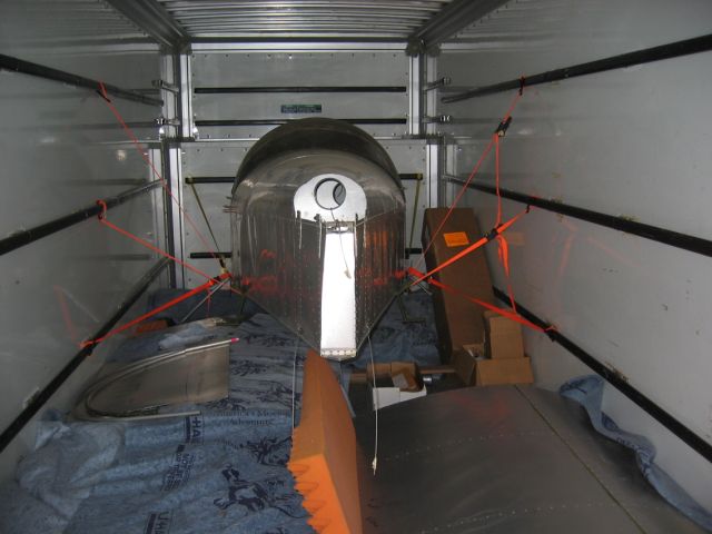

My 601XL fit in a 24 foot U-Haul truck on its gear with wheels (but no
pants) . You need to visit an actual truck and measure it. The opening
(where the tracks run for the overhead door) *is* too narrow. But you pass
the gear through at an angle and then straighten out. Picture attached.

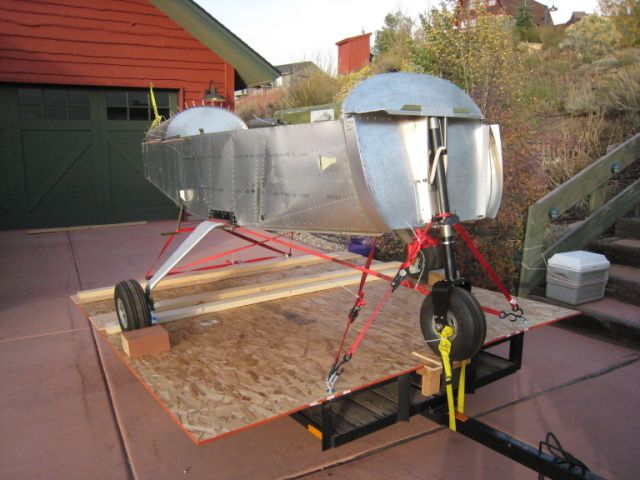

For short trips the trailer with outriggers also works. I drove mine 20
miles. See the second picture. Those are full 4*8 panels of chipboard. You
can see the ramps I used to roll the plane aboard bolted underneath the rear
of the fuselage. What you can't see are the 2*4 stiffeners underneath the
deck.
