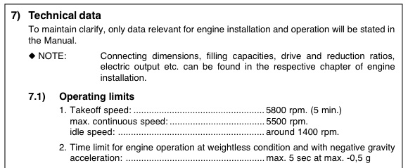

I keep hearing many folks on this list saying that 1800 rpm is minimum recommended idle speed for the 9 series Rotax engines. Can someone show me in the Rotax Documentation (not Lockwood) where it says that? The reason I ask is that the attached file is a snapshot from my 912S Installation Manual.
As you can plainly see it says IDLE SPEED AROUND 1400 RPM. I'm going to piss off some folks here with my next statement. If you can't get yours to idle smoothly at less than 1800 rpm, perhaps you ought to have a professional mechanic do it for you, because something may be amiss in your procedure or your engine.
As the owner operator of your airplane, you are entitled to set your idle speed at anything you want. If you are happy with 1800, then so be it, but don't tell me THE MINIMUM RECOMMENDED IDLE SPEED is different from what the Rotax Installation Manual says unless you can document that in another Rotax Document.
