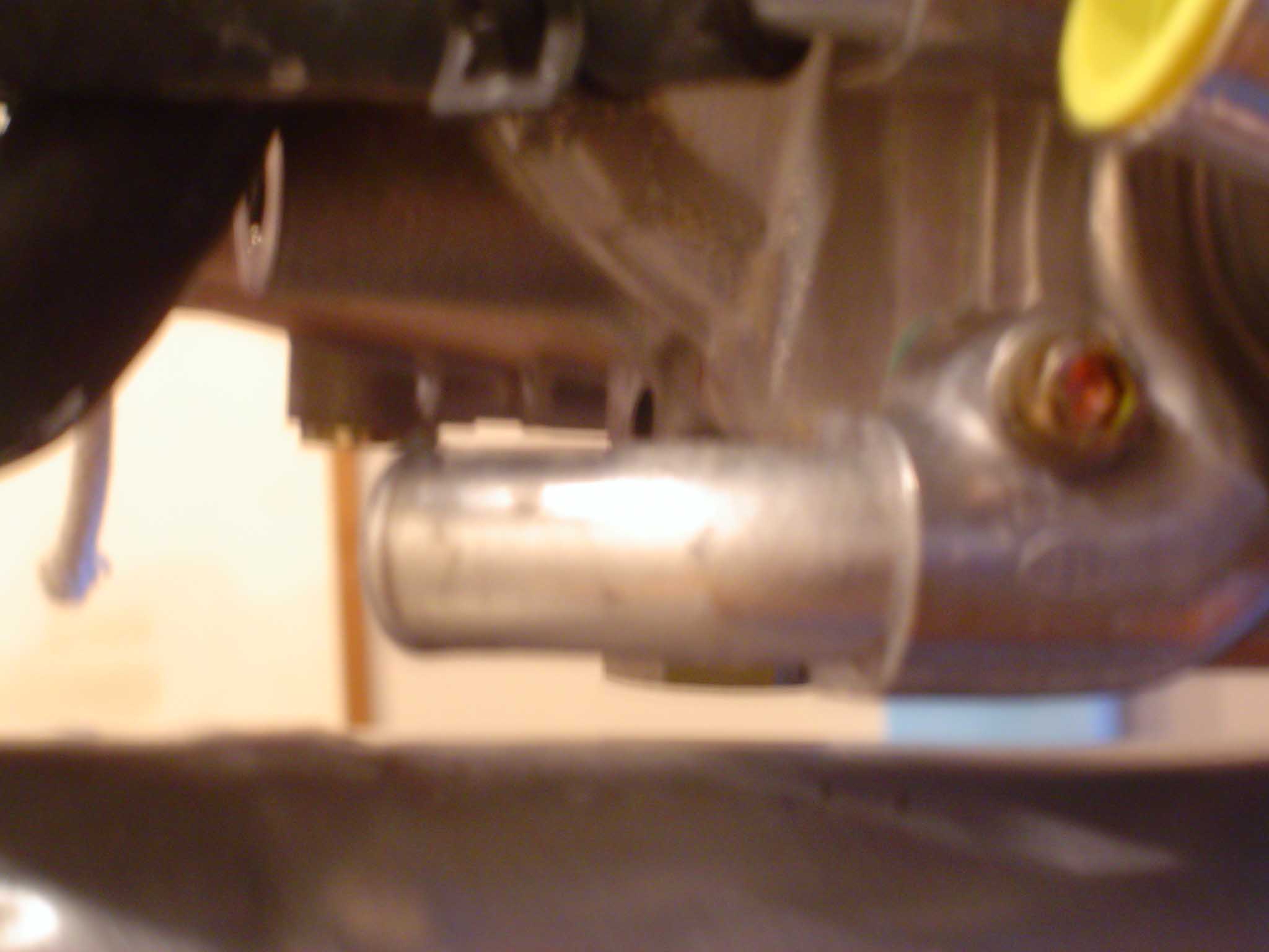

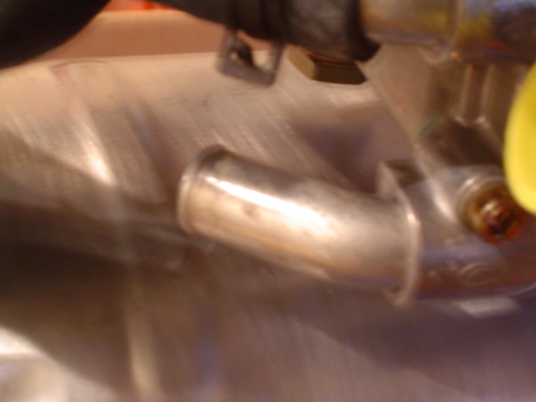

Bud, the bent nozzles from the water pump housing seem to already have a bend of around 40 degrees, certainly not 80 degrees - 2 photos attached with the standard Europa XS exhaust system temporarily fitted. The hose from the lower nozzle is disconnected. The clearance between the end of the lower bent nozzle and top of the silencer is 15 mm - is that sufficient? To increase the clearance a bit it seems I would have to rotate the bent nozzle upwards a bit.
I just wanted to clarify what you mean by an 80 degree bent nozzle - I presume you mean bent to nearly a right angle. If so, my engine doesn't have those. Maybe they have chenged them on recent engines? My engine serial no is 5647439. So I presume, if I have not misunderstood you, that I don't need to change the nozzle? Is that correct?

I see you have the 45 degree nozzle on the lower left exit from the pump. You're correct to presume that the nozzle need not be changed out. If you can bend the lower nozzle upward so that both cooling tubes go through the V in the ring mount that will give you about another 15 mm clearance. At about 30 mm, with heat shielding, you will be able to get a long service life out of your lower hose.
