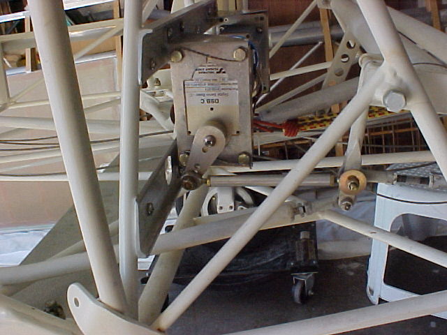

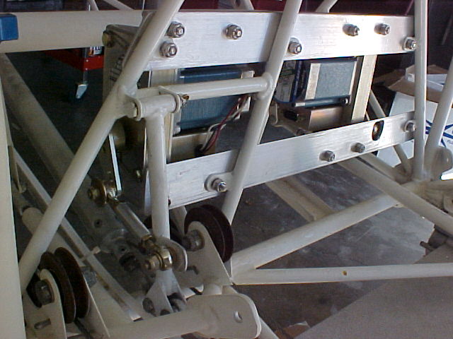

I checked out a few servo installation including a picture from Trutrak. Not so happy with any. I mounted mine behind vertical tubing aft of the seat. The simple mount allowed me to attach short servo rods. Okay, I did weld a couple mounting tabs and one tab onto pivoting support tube for the elevator tubing.. If the pHoto's don't come through e-mail me direct. michaega(at)verizon.net (michaega(at)verizon.net)
