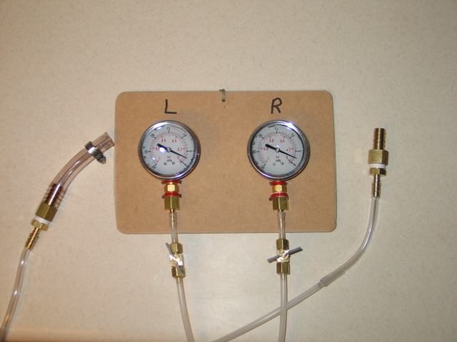

You are right the manual does say that. Yes you can get it to idle at those lower rpm's, but the reason Rotax teaches in their schools to idle around the 1800 mark is for the protection of the gearbox and other parts effected by vibration. Because the 100hp has more compression than the 80 hp engine at low rpm's it bangs away at the gearbox and the mating parts inside including the overload clutch. No matter what the engine will idle smoother at 1800. The chance of losing and engine at idle on approach is much higher at 1400 rpm settings also. Those are the reasons, not that you can't make it idle at 1400 it's the higher compression hammering and chugging along on the parts with the 100hp because of the good compression. You may never have an issue at 1400, but later down the line you may have to do more service work sooner than the other guy on your gearbox.
You can prove this to yourself using a dial indicator. Set it up against the outside area around the gearbox (so the motion will be left to right) and let the engine idle at 1400 and then do it again and let the engine idle at 1800. The dial indicator will have less impact and movement at 1800. A big factor in this vibration is as Thom has pointed out that the carbs must be properly synced.
I have posted a picture of a gage set on this forum. It is a liquid filled calibrated set you can put together for about $55 and it is very easy to work with. I Have talked many many people through a carb balance over the phone and you are welcome to call any time. You don't need to spend a lot of money on a balancing system, but just understand what is going on when you do certain things. Each person likes different instruments and tools.
520-574-1080 in Tucson, Az.
A carb balance should take less than 30 min. after you have done it once. It is not something to be afraid of it is relatively easy once you understand what certain things do when you turn a screw or cable.
