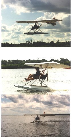

In a message dated 12/26/2007 9:39:59 P.M. Eastern Standard Time, d-m-hague(at)comcast.net writes:
As far as I can see, there is no mention of mono floats, just "30 lbs per float". In the case of flying boats, it's still 30# (plus the 10 for each outrigger).
I like the idea of the mono float for the US, to keep the spray off the prop. One thought I had was two floats (so you get the 60#) very close together, with a solid web between (almost like a tunnel hull racing boat). You could still add outrigger floats if necessary.
I still think I'd rather go into, say, a plowed field with non amphibious floats than straight wheels. There are quite a few videos on youtube of seaplanes landing (and even taking off!) on wet grass.
-Dana
Dana, Have you done any water flying, There is a major difference in Seaplanes (MonoHull) and Floatplanes.
Water Handling
Looks
Flight qualities
I personally like the look of a Floatplane and everthing that goes with it. Mono floats added to land plane tend to look Goofy.
Rare photo of Ultrastar on floats
Steve
Firefly 007/Floats
