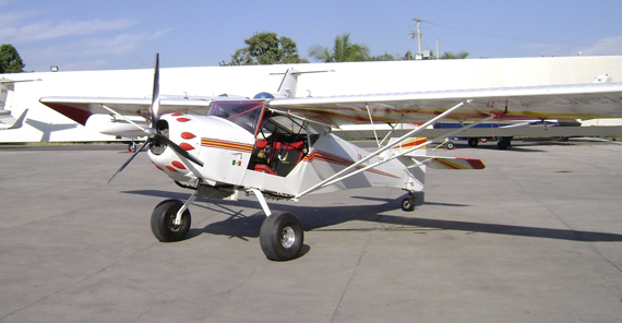

A few months ago there was talk on the list about bush tires on Kitfoxes.
Please find attached a picture of my KF3 with Nankang tires. I've rolled the plane up to 45MPH (well above normal operating speed) and they roll just fine and landings are a little more forgiving.
Charlie

The tire size is 21 x 12 - 8. The model number is N800 and the part number is T30151002, they cost $27.64 each plus shipping. They'll arrive tied together and it's a little tricky getting the tires mounted since they are collapsed and don't seal against the rim. I tied a tourniquet around the periphery of the tire and this forced the inner tire to mont on the rim and hold the 5 PSI the tires need to roll your Kitfox.
So far I have about 60 landings on the tires and they have been a joy. Expect a very mild jolt when you touch down on asphalt, since there is a lot of tire that has to get spinning, but landing on grass or gravel is is always a charm. On a tail dragger, your prop will have about two extra inches of clerance. I cannot say how much cruise speed has been effected by the new tires, but what ever it is, it's minor. The tires wiegh the same as the original tires the kit came with.

Max gross for the Grove landing gear on the Kitfox3 is 1,200 Lbs.
The tires are rated to only 355 lbs at 5 PSI, so I keep my gross weight to no more then 710 Lbs.

I think you might be underestimating the Nankang tires. I flew with them on
my Model IV for about three years and never hesitated to fly at 1200 lbs.
This flying included lots of off pavement landings. I suspect the tires are
rated as they are because they are designed for the ATV market where rough
terrain at fairly high speeds is common. After my chrash landing, which
tore the aluminum spring gear off the airplane, one of the Nankang tires was
still inflated and the other was flat. I didn't have time to carefully
examine the flattened tire to determine why it lost air.
I am not suggesting abusing any of the equipment we use, but in this case, I
think in the normal use of these tires on our airplanes, they are fine up to
the rated weight of the airframe in the earlier models.
Yes, these were the tires sold as Kingfox.
