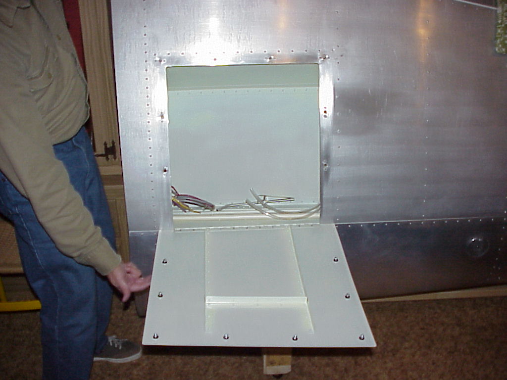

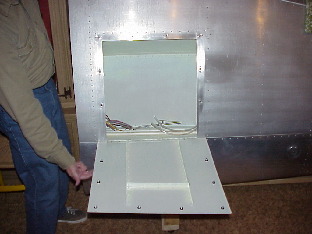

ker, the difference though is that the TRUE cantilever part of the wing on
the HD is outboard of the wing locker area due to the fact that the wing
on the HD is a three part deal, the 8 foot center section and two 8'
outboard panels, both of which are solid and shorter and the wing locker
is essentially part of the center wing section, not part of the seperate
and shorter wing panels.
My lawd!!! I built mine incorrectly!!! I put them in the outboard wing
sections according to plans!!!
This whole rehashed, dead horse, emotional, subjective,
wait-a-minute-I-have-an-opinion-and-I'll-state-it-until-the-cows-come-home
thread on XL wing structure "shortcomings" would be laughable were it not
for the verbal irony of the spelling of the word "failiers" which began the
debacle. If you don't trust the testing done to the design then you want to
decide whether to continue with the build. If unsure about lockers then
omit them.
