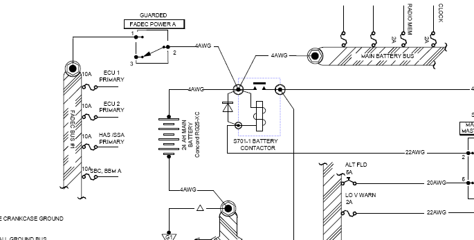

I am currently working on my wiring diagram for my FADEC equipped
plane. I will be using a slightly modified version of the Z-14
diagram. I found a fellow builder with the same setup as me and got a
hold of his wiring diagram. Attached is a snippet of that diagram. My
question pertains to the guarded switch for FADEC bus #1 (there is a
similar setup for FADEC bus #2). The diagram is showing 4 AWG wire
between the battery and guarded switch. Shouldn t there be a relay or
something here?
Jason
I would rather see the FADEC equipment drive from
the Main Battery Bus with switching for each feeder
supplied downstream of the fuses as appropriate.
Without having detailed data on the functionality
of your FADEC system and its failure modes, it's
not possible to offer a well considered recommendation.
If your system demands an architecture like you've
illustrated, then the switch should be a relay (solid
state perhaps?) right at the battery. The 4AWG wire
cited can probably be MUCH smaller.
