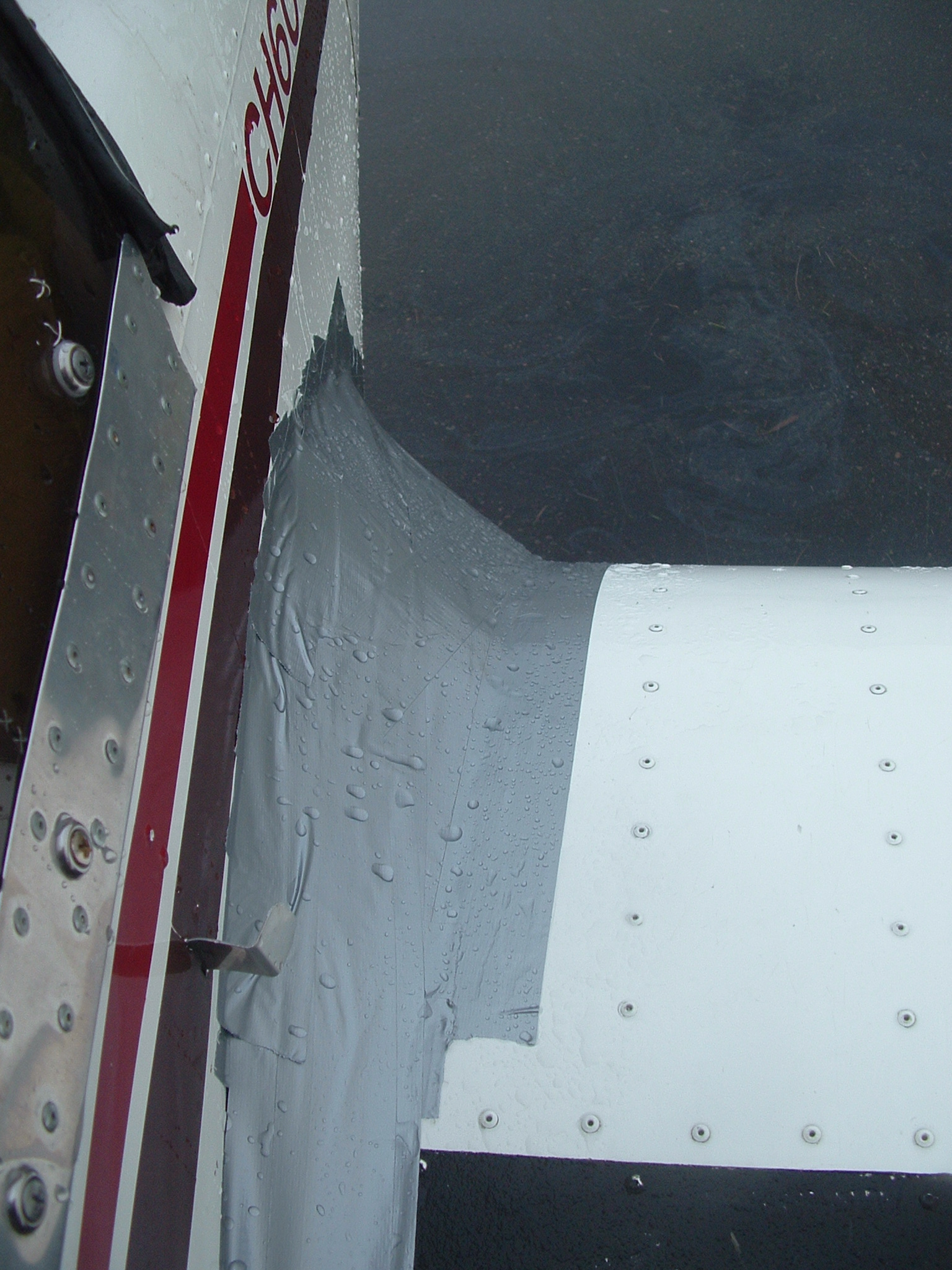

PostPosted: Sun Dec 16, 2007 10:11 pm    Post subject: Re: 601 and wing failiers Reply with quote
Laughing I trust the wings of my 601 but helped with some insurance Laughing
This will help keeping the wing on my plane !!:)

annken100
Joined: 15 Nov 2007
Posts: 62
PostPosted: Sun Dec 16, 2007 10:31 pm    Post subject: Re: 601 and wing failiers Reply with quote
Shocked Funny!
Is that modification patented? What thickness duct tape did you use? Have you run it by Zenith yet?
Ken Pavlou
601 XL / Corvair[/quote]
Canatukker
Joined: 03 Feb 2007
Posts: 12
Location: Mission(Hatzic lake)B.C. Canada
PostPosted: Sun Dec 16, 2007 10:58 pm    Post subject: Re: 601 and wing failiers Reply with quote
Cool don't know how thick ,is already patented
Scotch® All-Weather Duct Tape
Apollo 13 astronauts used it for repairs and the Apollo 17 astronauts to keep dust off the lunar rover’s fenders; it is now policy to have a roll on every space shuttle mission Idea Ron in a can't fly to rainy Mission B.C. good o'l Canada
do not archive Crying or Very sad

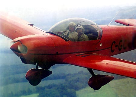

ashontz wrote:
Is this the factory demo plane. It DOES NOT APPEAR to have the wing lockers. Personally, I'm very suspicious of the wing lockers. Granted, they may be fine in testing, but if the accident planes failed due to over stressing that would be where the stress would accumulate most, right at the wing locker area. Skins in tension are strong, skins in compression, or areas in compression where there are no skins, like the wing locker, would be particularly prone to failure first. If there is anything wrong with this design, I'd say this is it. I'd have to guess the wing is considerable stronger without the wing locker. Eliminate the locker and you eliminate one more stress point in an area that's already fairly stressed as it is as well as being even more diminished in capacity to deal with compression forces due to the locker. It would be interesting to see if these wings that failed also had wing lockers. Seems as those the wong locker idea is a carry-over from the 601HD wing loc!
ker, the difference though is that the TRUE cantilever part of the wing on the HD is outboard of the wing locker area due to the fact that the wing on the HD is a three part deal, the 8 foot center section and two 8' outboard panels, both of which are solid and shorter and the wing locker is essentially part of the center wing section, not part of the seperate and shorter wing panels.
[quote="ggower_99(at)yahoo.com"]One thing that gives me trust in the design are the lots of hours that some of the older 601 XL have already acumulated. Not mentioning the previous 601 series (HD; HDS, UL).
The factory prototype has the same wings since his first flight and is a plane that is flying every day as a demo, also travels a lot to Fly ins and Aviation events...
