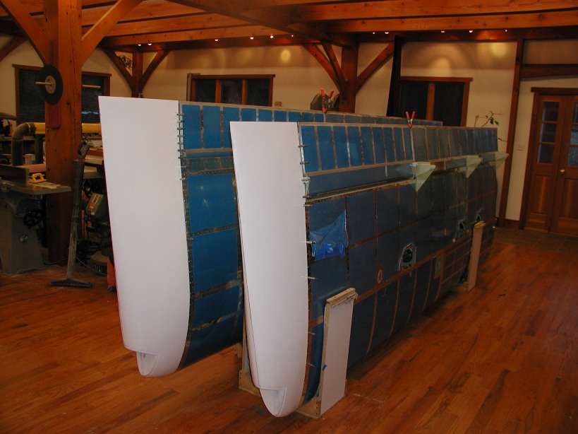

rnewman(at)tcwtech.com
PostPosted: Sun Dec 16, 2007 5:38 pm    Post subject: wing tip Reply with quote
Chris, Other's will have to chime in, especially those flying. When I did my wing tips I used the "neutral jig" which sets the aileron neutral position, checked and aligned the flaps to the ailerons and then set my wing tip trailing edges to the ailerons. I believe I had the "old version" of wing tips as they were about 3/4" longer than the aileron, but none the less, I had to cut the upper and lower wing tip surface at the trailing edge to pull the wing tip into alignment with the aileron. I used a long straight edge to align the wing tip to the aileron and used it as a clamping jig while the resin dried. I remeber cutting about 3" forward from the trailing edge to give the upper and lower tip skin some compliance so I could easily align it with the aileron. When I was done it came out swell.
Here's a picture when it was all done.
-Bob Newman
TCW Technologies
www.tcwtech.com

jim(at)CombsFive.Com
PostPosted: Mon Dec 17, 2007 5:21 am    Post subject: wing tip Reply with quote
Bob,
That is one sweet workshop!
Jim C
