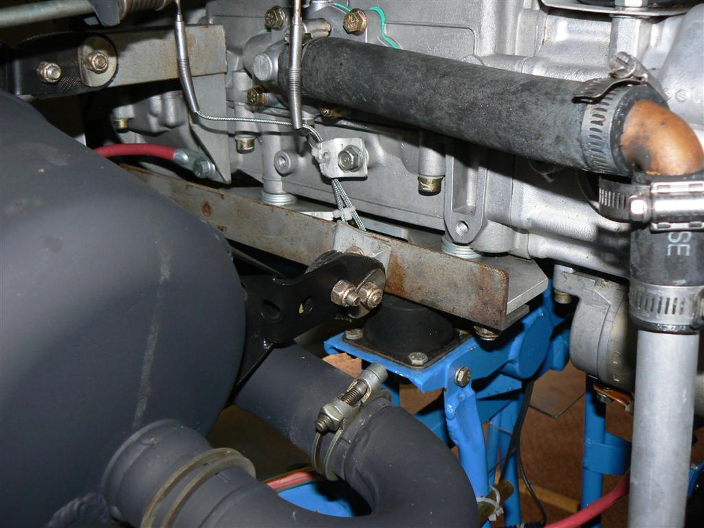

Here are some pictures of how we did it. Turned the rubber Lord mounts over to gain some room. Had to do that because otherwise the studs coming out the bottom of the engine fouled the airframe in the further aft position.
Got two lengths of angle iron and sat them on top of the Lord mounts. Then the stock aluminum mounting plate & engine sits on them and is slid toward the aft end of the airplane until the starter clears the back of the fuselage structure.
Probably could have done it lighter and more elegantly, but it sure is simple and bulletproof... Besides, with a 582 on a FSII, always flown solo, the couple of extra pounds is not really an issue.
In a couple of the pictures, you will also notice the extra structure we added to beef the motor mounts to handle the extra torque of the 582. Even so, we didn't get factory approval, but we did get a grudging concession that we were unlikely to wring anything apart. And that's good enough for us.
