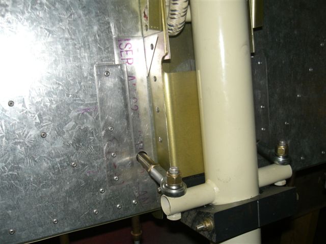

Not an original idea, but this is my version of the slot cure. The rods are covered with a 2 1/2" length of vinyl tubing to smooth the threads. The holes are slightly oversize to prevent binding. The outer piece is shimmed, and then bowed in just enough to keep the slider from rattling. The slider is allowed plenty of lateral clearance so it can move as needed. No cost, very little weight, about 2 hours from beard stroking time to completion, and not made in China.

PostPosted: Sun Dec 09, 2007 10:02 am    Post subject: Re: 601 steering slot cure Reply with quote
I like it. Good work.

PostPosted: Mon Dec 10, 2007 8:13 am    Post subject: Re: 601 steering slot cure Reply with quote
One thought came to mind on this, the vinyl tubing you used. What is is temp rated to?

PostPosted: Mon Dec 10, 2007 11:40 am    Post subject: 601 steering slot cure Reply with quote
I wrapped sheet aluminum from a beer can around the threads of my steering
rods to smooth them out. Others filled in the threads with JB Weld.
-- Craig

PostPosted: Mon Dec 10, 2007 2:41 pm    Post subject: 601 steering slot cure Reply with quote
I replaced the stock steering rods with steel rod from the local hardware
store. I threaded the ends as required, but the section that passes thru
the firewall slots remains smooth.

PostPosted: Mon Dec 10, 2007 3:08 pm    Post subject: 601 steering slot cure Reply with quote
Lavatory faucet supply line (chrome plated copper tubing) sliding through nylon grommets.
