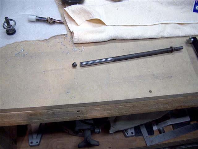

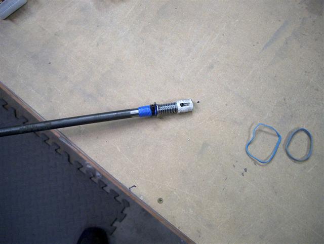

If you are referring to the rivets holding on the bottom skin right next to the flap attach arms (I think there are 4 on each side) I used a long backrivet set with the collar removed. Do make sure the face is polished very smooth or it will mar up the skin pretty good. Be sure to be perfectly perpendicular too as the edges have no bevel or curve in them. Turn up the air pressure cause the long set absorbs a lot of impact.
I actually made my own backrivet set out of a 12” long cupped set that I got on ebay (see pictures attached). It came with a gaggle of sets and bars that were for a rivet sizes I’d never heard of. I cut the end off flush and polished the thing up real good. At home depot I found a pvc fitting that fit it like a glove and cut it up to work like a standard backrivet set. The spring that came with the avery c-frame seems to work pretty good holding pressure on the pvc fitting.
-Ben Westfall

PostPosted: Fri Dec 07, 2007 10:23 pm    Post subject: Trouble with riveting on rear spar at flap bracket. Reply with quote
If I didn’t make it clear the backrivet set was used as a regular set on the manufactured head of the AN470 rivet and my wife bucked the shop head per usual.
