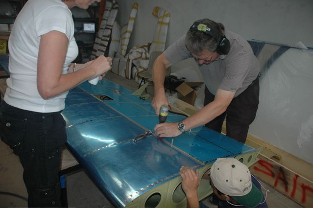

PostPosted: Thu Dec 06, 2007 4:59 pm    Post subject: closing up the bottom wing skin. Reply with quote
Flat on the bench is what seems to work best, with a helper at least. Haven't seen them done or tried to do them solo, but it sounds like it can be done. What we have found is that taping some foam around the bucking bar except the face that hits the rivet is also helpful in case you drop it.

PostPosted: Thu Dec 06, 2007 5:15 pm    Post subject: closing up the bottom wing skin. Reply with quote
Ditto on taping the bucking bar; we use small pieces of silicone baffling material to protect adjacent surfaces from the stray trajectories of the bucking bar. Also when two surfaces are not clamped tightly together before riveting, it is sometimes necessary to use a draw bead made of silicone rubber to set the rivet so that the first strike of the rivet gun sets them together. I believe I sent pictures of a draw bead and described its use in previous posts.
