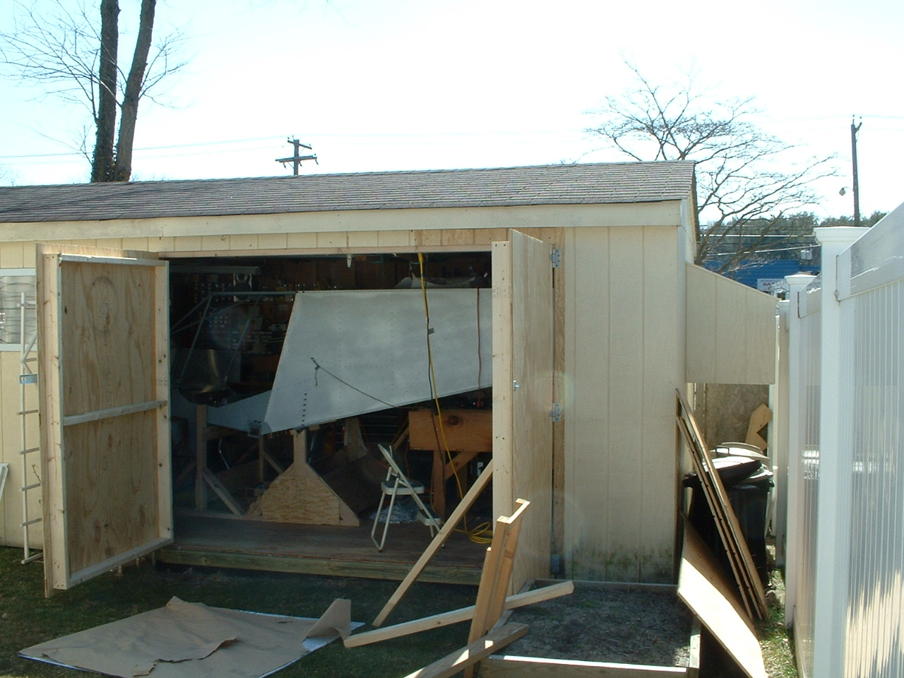

Geoff Heap
Joined: 12 Jan 2006
Posts: 266
Location: Lindenwold, New Jersey
PostPosted: Thu Nov 29, 2007 4:51 am    Post subject: Re: Drill Press Reply with quote
...and if you're really stuck for floor space..see pic

PostPosted: Thu Nov 29, 2007 2:03 pm    Post subject: Re: Drill Press Reply with quote
Wow! Thats tight!
Kevin

PostPosted: Fri Nov 30, 2007 10:02 am    Post subject: Re: Drill Press Reply with quote
You crack me up man.
