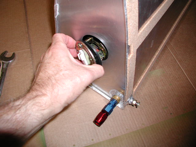

Upon reading some advice posted by others on the list, I used only one of the rubber gaskets on the external surface of the fuel tank. When mounting the sender to the tank, I liberally applied fuel lube to the outside of the perimeter of the hole, to the both sides of the rubber gasket, and to each of the screws. The excess is mostly easy to wipe off after you compress the gasket with the screws (don't overtighten) but you may want to wear some latex gloves when applying the fuel lube. The fuel lube is available from Aircraft Spruce under the name EZ Turn, but a search there for fuel lube works.
Dave Gardea
