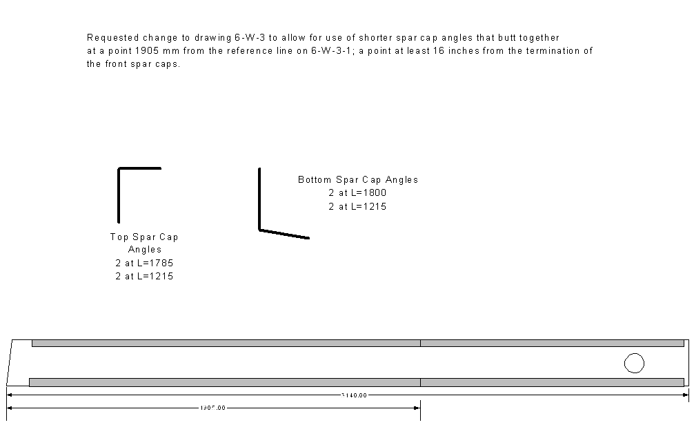

Not the rear spar splice, the butt joint for the spar cap angles on the main spar. They can be made in two sections, but there should be a doubler that spans the joint.

I had access to an 8 ft. break so spliced the spar caps 8 & 4ft. on top and 6 & 6 ft.for the bottom. I made two 8" splices out of .035 and secured them on the bottom side of the angles with 2 small flush solid rivets, spaced to miss the A5's when I drilled and riveted the skins into the caps. Make sure to drive the Solid rivets through the spar web and caps to respect all edge distances.

PostPosted: Sun Nov 25, 2007 5:32 pm    Post subject: Spar cap angles on 601xl Reply with quote
Approved by Chris Heintz
Mark Townsend Alma, Ontario

Funny, I just talked to I believe it was Sebastian and he was like "uh, I'd imagine a doubler with 5 or 6 rivets either side would be a good idea."
So what's the final word on this before I go pulling out the doubler I have in there and making it longer. Looking at the FAA Advisory Circular under Repairs (seeing as how the butt joint is essentially the same as a crack, for .032 you'd need a 1.5 times the thickness doubler with 5 rivets either side. Good guess on whoever at Zenith gave me the thumbs up. Still, I'd like to know if they do or don't require it in this approved design change.

PostPosted: Mon Nov 26, 2007 7:14 am    Post subject: Spar cap angles on 601xl Reply with quote
Hi Guys.
When we originally proposed this butt joint to Chris
Heintz the first question was whether or not the spar
cap angle was used in the strength calculations of the
spar or if its purpose was simply to attach the skins
to the spar. All the spar cap angle does is transfer
the load from the skin to the spar. We could have used
a whole bunch of little angles (one for each rivet)
but it is simpler to use less (one or two) Therefore
no doubler is required.
We recognize that it does carry some of the load of
the spar so it is important to have the butt joint
located away from the termination of the front spar
caps (top and bottom) to avoid stress concentrations
at that location. Mark Townsend mentioned 16 inches I
believe. I hope this clarifies things somewhat.
David
