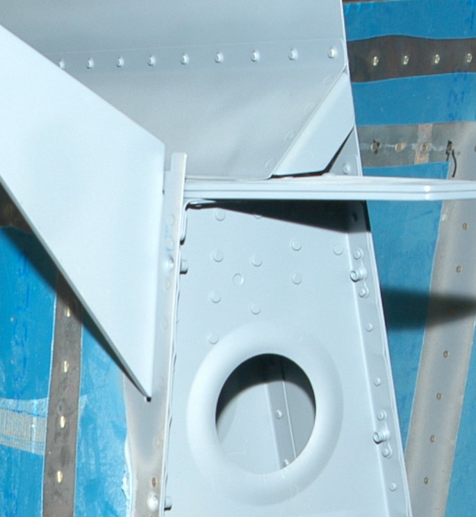

Happy thanksgiving! i know it's a holiday, because i always end up with
a problem on the start of a holiday.
http://www.jline.com/log/aviation/build/airframe/wings/photos/sec20/IMG_5509.html
http://www.jline.com/log/aviation/build/airframe/wings/photos/sec20/IMG_5510.html
The above photos show the bottom inboard wing rib. You can see where one
of the nutplate hole patterns in the skin, lines up right between a
notch in the rib flange.
On page 20-6, it calls for a K1100-08 here, which matches the hole
pattern pre-punched into the bottom skin, but this will make for an
awkward rivet in the notch without a shim or another type of nutplate.
Nothing in the archives about this. What am i missing or did i do wrong?

Here's a photo of mine; I was told to just rivet it (the rivet will expand slightly):
[img]cid:part1.07070904.04040503(at)arrl.net[/img]
-Jim 40384

PostPosted: Fri Nov 23, 2007 9:02 am    Post subject: pg 20-6 inboard bottom wing skin nutplate Reply with quote
Jae;
I went out and looked at my wings. Did the same thing. Just put the
nut plate over the end of the gap. Just like Mr Hein's pics.
Fred

PostPosted: Fri Nov 23, 2007 3:32 pm    Post subject: pg 20-6 inboard bottom wing skin nutplate Reply with quote
ok, thanks James and Fred for confirming!
Jae - 40533
