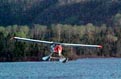

I was looking into increasing the MTOW of my model III-A from 950 to 1050 last year. I think it was Dave Fisher who sent me a drawing of an upgrade that included the installation of a heavier pass through tube for the wing struts (bottom of the plane) and also two additional frame braces in the same area on each side of the plane...
To make a long story short, I have no appreciable welding skills and I don't want to strip the cloth off my plane to start hacking more tubing in. I wouldn't have any problem with flying my floats at 1050 lb. I would take into consideration that I was heavier than design standards and pass on some more extreme manoeuvres. So far I still haven't reached the 950lb. gross and I still pass on extreme manoeuvres.
