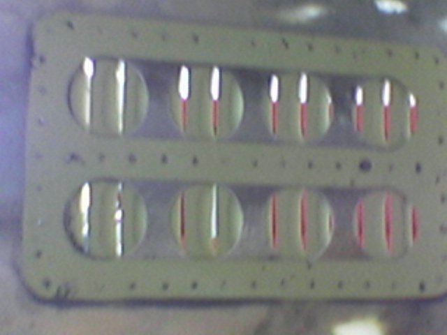

PostPosted: Thu Feb 23, 2006 7:27 am    Post subject: NACA cockpit cooling vents Reply with quote
Milt,
I'd like to see pictures of your louvers...

n395v
Posts: 450
PostPosted: Thu Feb 23, 2006 3:19 pm    Post subject: Re: NACA cockpit cooling vents Reply with quote
The following is a series of attachments if you view the bulletin board.
If they are stripped from your e mail version let me know an I will e mail them to you.

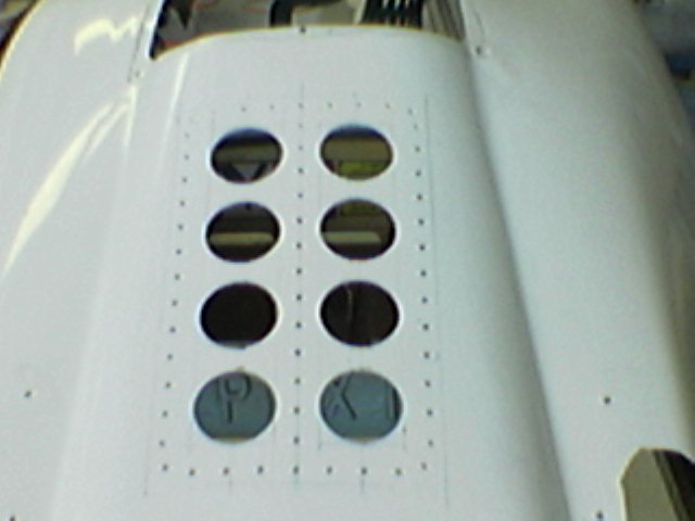

#1

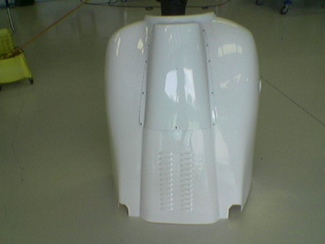

PostPosted: Thu Feb 23, 2006 3:21 pm    Post subject: Re: NACA cockpit cooling vents Reply with quote

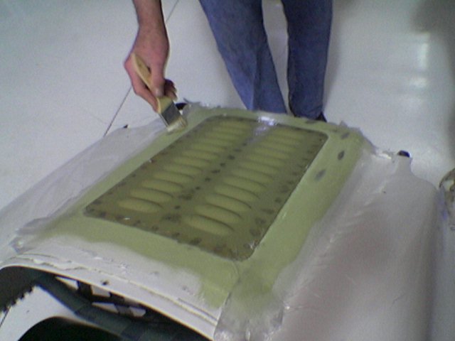

#2 if you need more flow just cut out some of the cross bridges.

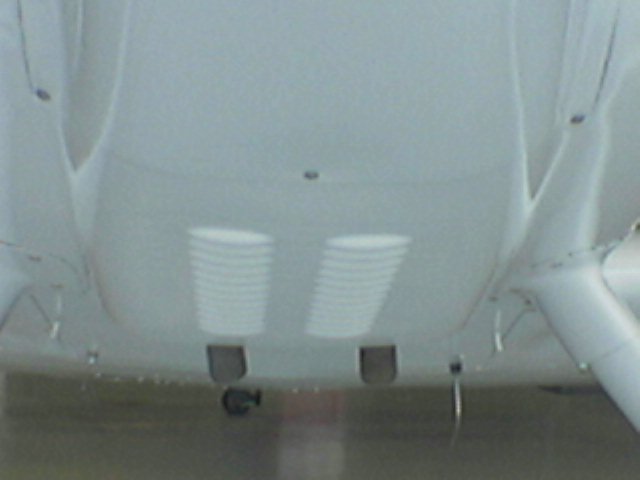

PostPosted: Thu Feb 23, 2006 3:22 pm    Post subject: Re: NACA cockpit cooling vents Reply with quote

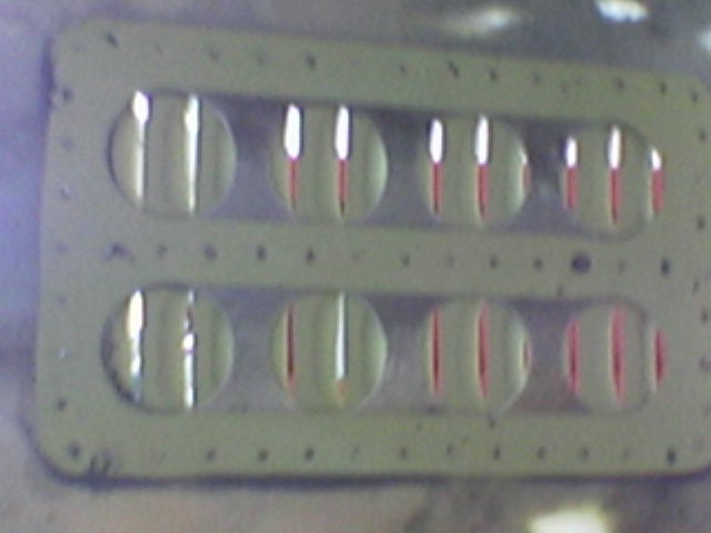

#3

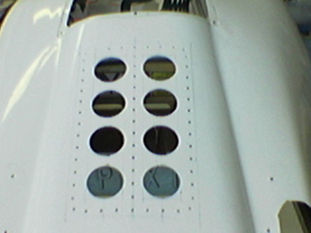

PostPosted: Thu Feb 23, 2006 3:24 pm    Post subject: Re: NACA cockpit cooling vents Reply with quote

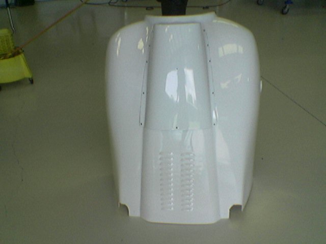

#5
The finished product Very Happy

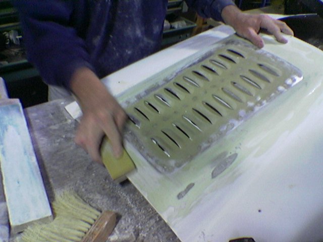

The first thing we learned is that what we learned in A&P school was just, flat, wrong. The air does NOT come in, go to the back plate, pressurize the cowl and go down through the fins. Nothing could be farther from the truth.
The BASIC airflow is that the air enters the cowl openning at the outboard edges of the openning. It passes along the outboard edges of the cylinders until it gets to the back plate whereupon it turns inboard and meets the air that came in the other side right over the spine of the engine. This results in the air moving forward along the spine of the engine case toward the spinner where it exits the cowl and goes over the windscreen aft! That's why you get oil spots on the windscreen when you have an oil leak!
Yep, about 70% of the air that comes in a cowl goes right back out the FRONT! That's why smaller opennings, limiting the air IN and baffles blocking the front are very helpful. If one tufts the cowl openning you will be surprised to see about half of those tufts pointing straight forward TOWARD the prop when in flight. That's the air going OUT forward.
The biggest advantage in cooling is created by slowing the air down on top and creating a large deltaP with the lower deck. That allows more air to work it's way through the fins and allow engine heat to move into the air. It is essentially impossible to make intelligent changes in cowl and baffle design unless you can WATCH the airflow with the changes. They can be very counter-intuitive.
We've fixed several problems that have existed for decades and we've run up on some to which the solutions remain elusive. One in particular really has me frustrated and downright chapped--dozens of brilliant ideas and sure-fire solutions have failed over many months of efforts.
Walter Atkinson
Advanced Pilot Seminars
