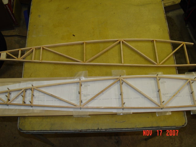

Working on my next plane - Wittman "Buttercup"
