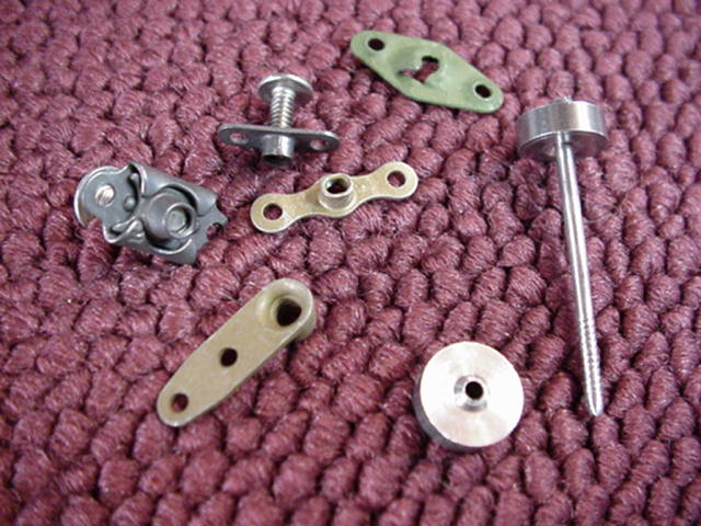

The first pix shows variety of what I used, the two in the center being most useful, the one in the upper right which is greenish in color is an anchor plate - you can see difference.

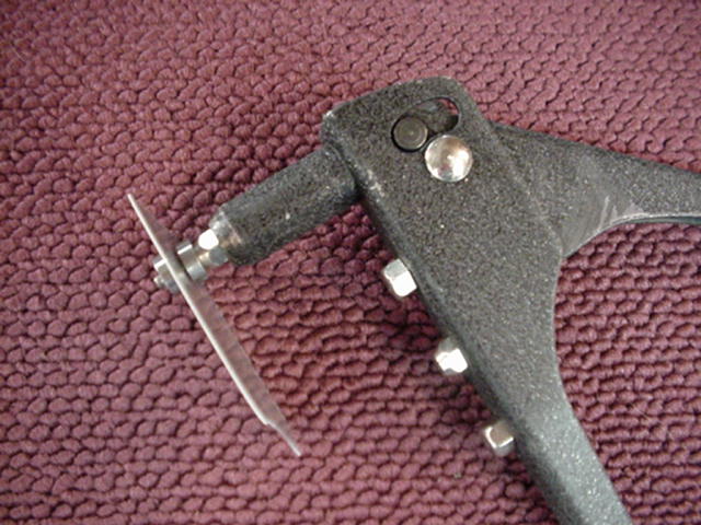

Second shows how to form dimple using your hand riveter.

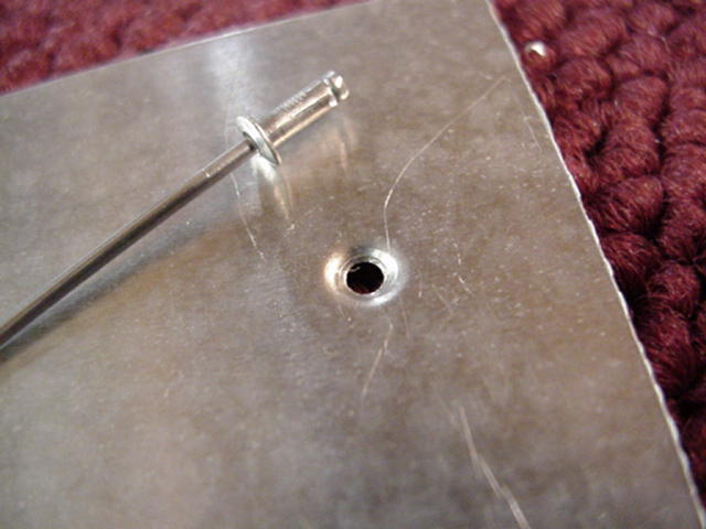

Third shows dimple. This could be cleaner up further if you have a micro-stop and #40 pilot cutter - go slowly as the .016 and .025 with which we deal doesn't allow much for error.
