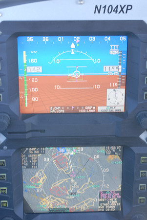

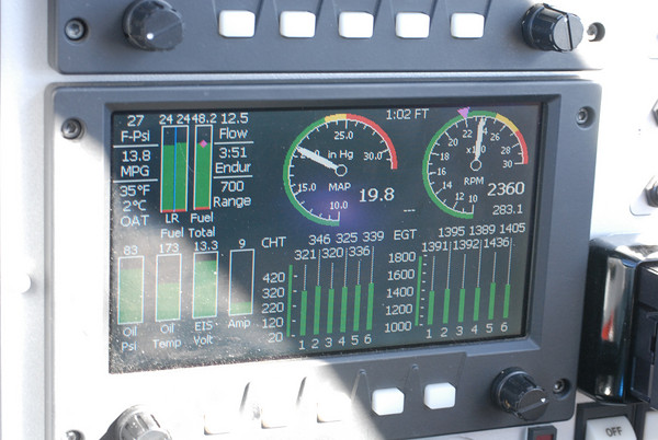

Here are a couple more shots just to prove that this plane will cruise at 170 knots. Here I am running ROP at 12.5 gph at 11,500. The TAS is 171 knots.
I should tell people the ad lies, it is actually faster than that.

177 seems kind of high to me, but that's what EFIS said and I'm as sure as 45 hours of experience can make me that it's right. I wonder if having a lot of nose down trim was a factor. I've heard that being tail heavy is more efficient because it unloads the main wing, but then again the lift (and induced drag) has to come from somewhere, even if it's from the tail.
I dunno. I'm anxious to get out there and get some more data, and see some cool stuff like those mountains, Scott.
