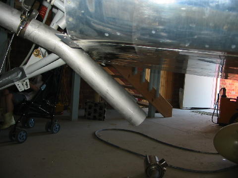

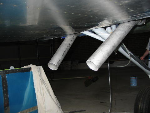

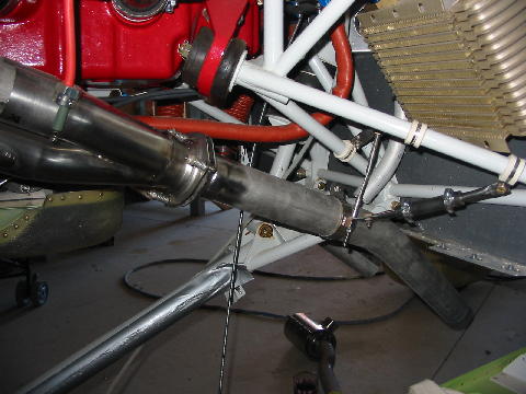

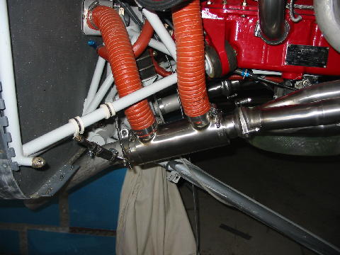

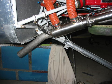

Guys I was not happy with Vans setup of rear part of exhaust etc. I also did not need the heat that comes out of those huge muffs into the cabin. I contacted Larry and he made these up for me . I was originally only going to change the passenger side but Larry said there would be a pressure change so I changed them both and now have the standard setup like we had in our 6. Because there is no baffle as such there is a slight power increase. I only had to change the rear part of exhaust and it was about an hours work. They are longer than the previous exhaust. As you can see there is now less clutter in the engine compartment.
Not intended to put anyone's exhaust down at all, just wanted to show what I have done.
regards Chris
