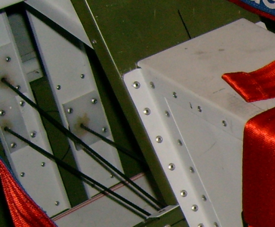

I have had to relocate nearly all of the fairleads behind the cockpit area. If you haven't installed the fairleads for your ailerons, don't rivet them in place until you run the cables and test them. Drill the hole in the aluminum large so you can move the fairlead to achieve clearance, then drill and rivet.
This is something Zenith has been "tweaking" for some time since my drawings are from 2002, there have been many changes on cable routing to make sure they clear all obstacles. Attached is a picture of my rudder and elevator fairlead locations.
Good luck,
Scott Laughlin
Omaha, Nebraska

Ruder and elevator cables

I like it, teflon blocks for the cables. Not sure if that's specified in the plans without looking at them, but it's a nice setup.

My advice is the same as Scott's. The fairlead locations should not be considered as fixed in concrete. It sounds like a little movement of the fairlead on the rear frame is all you need. My upper elevator fairlead also contacted somewhere in the seatback, I forget where, so I moved the fairlead a bit to eliminate the interference. I will be at the Jabiru seminar and look forward to seeing you there.

I had to monkey around a bit with one of my elevator fairleads too.... don't recall which onebut I think it was the bottom (up elevator) cable. Haven't donethe aileron fairleads yet but I have drilled a #30 size hole where the plans indicted as a starting point.
