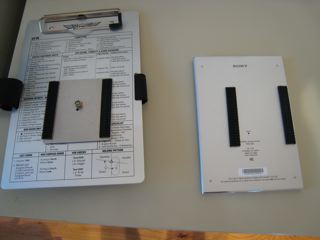

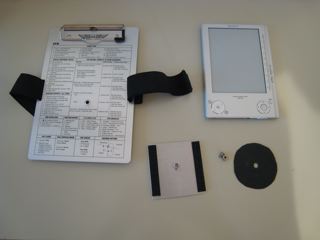

First picture shows an aluminum plate with couple of heavy duty velcro strips (they are about 3/16" thick), a hole I drilled and counter-sunk in the plate and the knee pad, the ereader and a plastic coffee can lid that provides the friction. Friction mechanism, courtesy of my smarter friends.

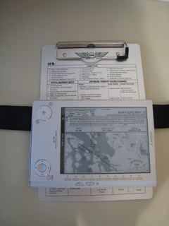

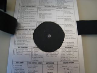

The second and the third pictures how they assemble.

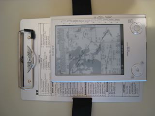

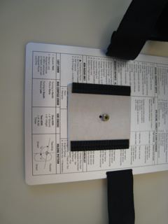

The forth picture shows the velcro on the back of ereader. I placed it based on my needs. You may place it anywhere you think will work for you. Also, the screw holding the assembly has to be cut very short with a low profile lock washer to fit under the ereader.
The next pictures show the different orientations. With the push of one button and flip of a finger, the ereader goes into landscape magnification mode.
