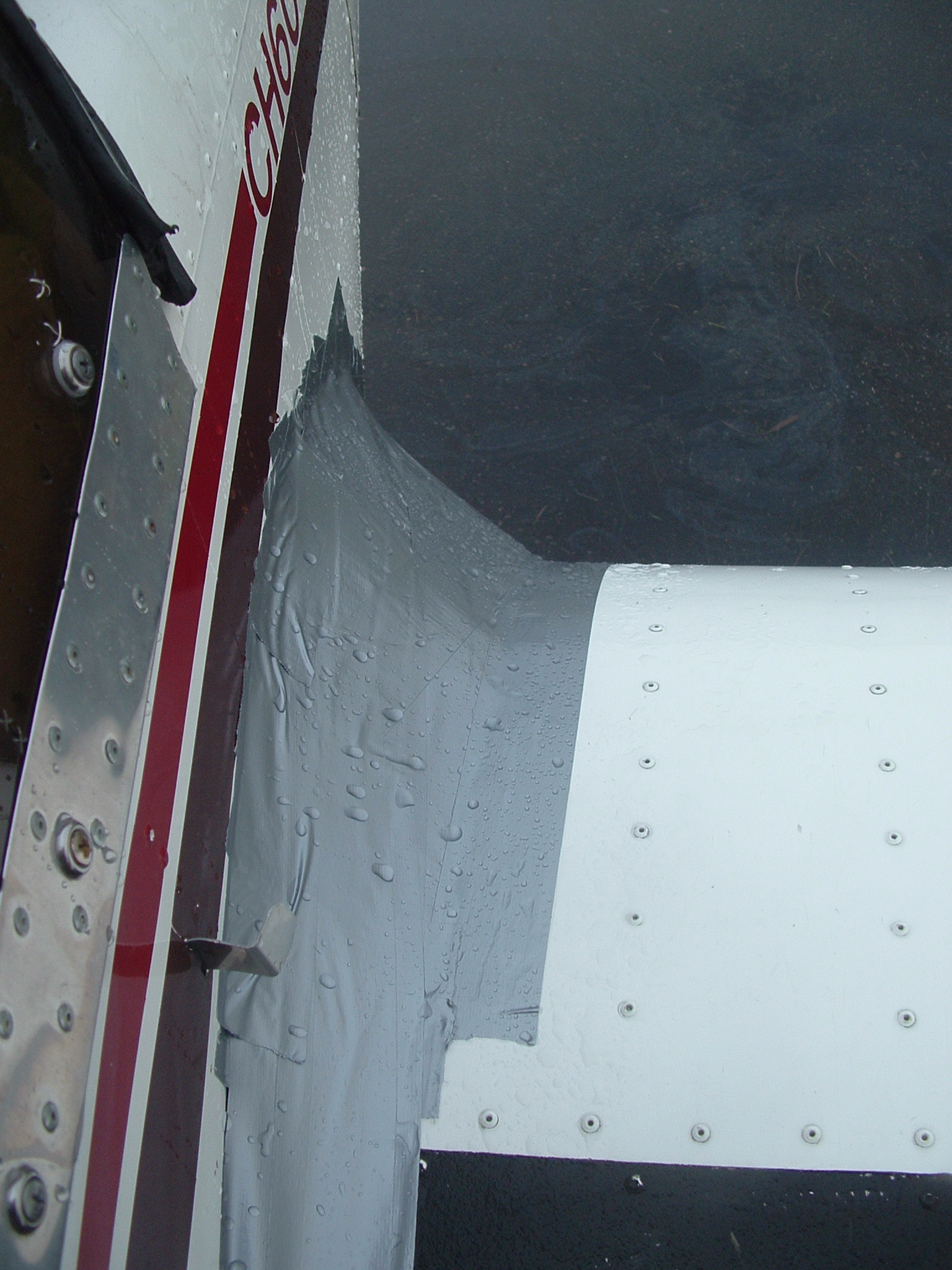

I have had my zodiac 601 UL from Feb. this Year and found the plane to glide like a rock and fly with a nose high attitude ,also the stall speed I found somewhat high . after reading Klaus's report on the Wing-root fairings and the phenomenal numbers of improvement on his HDS i could not wait to try it so weaponed with a roll of ductape I went to the airport and made fairings on the front part of the wing-root (works like magic) and went flying , the airplane is NOT the same anymore , she fly's like all the (Canadian 1232 lb max) ultralights I have been flying with a level attitude (I can now see over the nose ) specially on landing because we have a much better glide ,I have had not a lot off time to test all exact numbers ,but think Thad stall speed has not much changed yet(no fairing on back part of wing YET ) I LOVE MY REBORN PLANE !! and can hardly wait to bring out the fiberglass and make the fairings permanent Thanks Klaus for your research . if any of You guy's have experience with wing-root fairing please let me know . Ron Smit from a rainy Abbotsford Canada B.C. C-FNSR
Have fun fly safe

PostPosted: Sat Nov 03, 2007 9:21 am    Post subject: Re: Wing root fairings Reply with quote
Ok don`t laugh I have a link to some pictures of this very successful test .
Cool
http://picasaweb.google.ca/10avion/WingRootTest
Fly save have fun Ron.

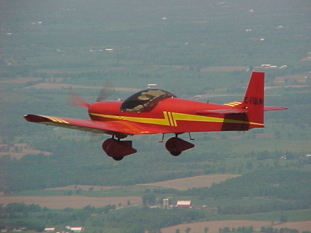

daveaustin2(at)primus.ca
PostPosted: Sat Nov 03, 2007 3:44 pm    Post subject: Wing root fairings Reply with quote
Wing root fairings.
Dave Austin 601HDS - 912, Spitfire Mk VIII
 Filesize:  39.27 KB
 Viewed:  935 Time(s)
