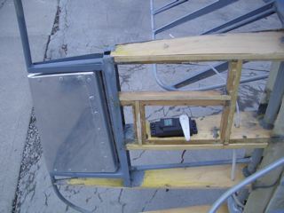

I have been using electronic rudder, elevator and aileron trim on my
Model 2 for several years and have not had any problems with flutter.
I have used heavy duty R/C servos with great success. So much so
that I am incorporating built-in servos on my Model 5, I have attached a
photo of the rudder servo installation.
JIm
Model 2, 582, IVO med IFA, 1100 hrs
Model 5 under construction
Calgary AB
